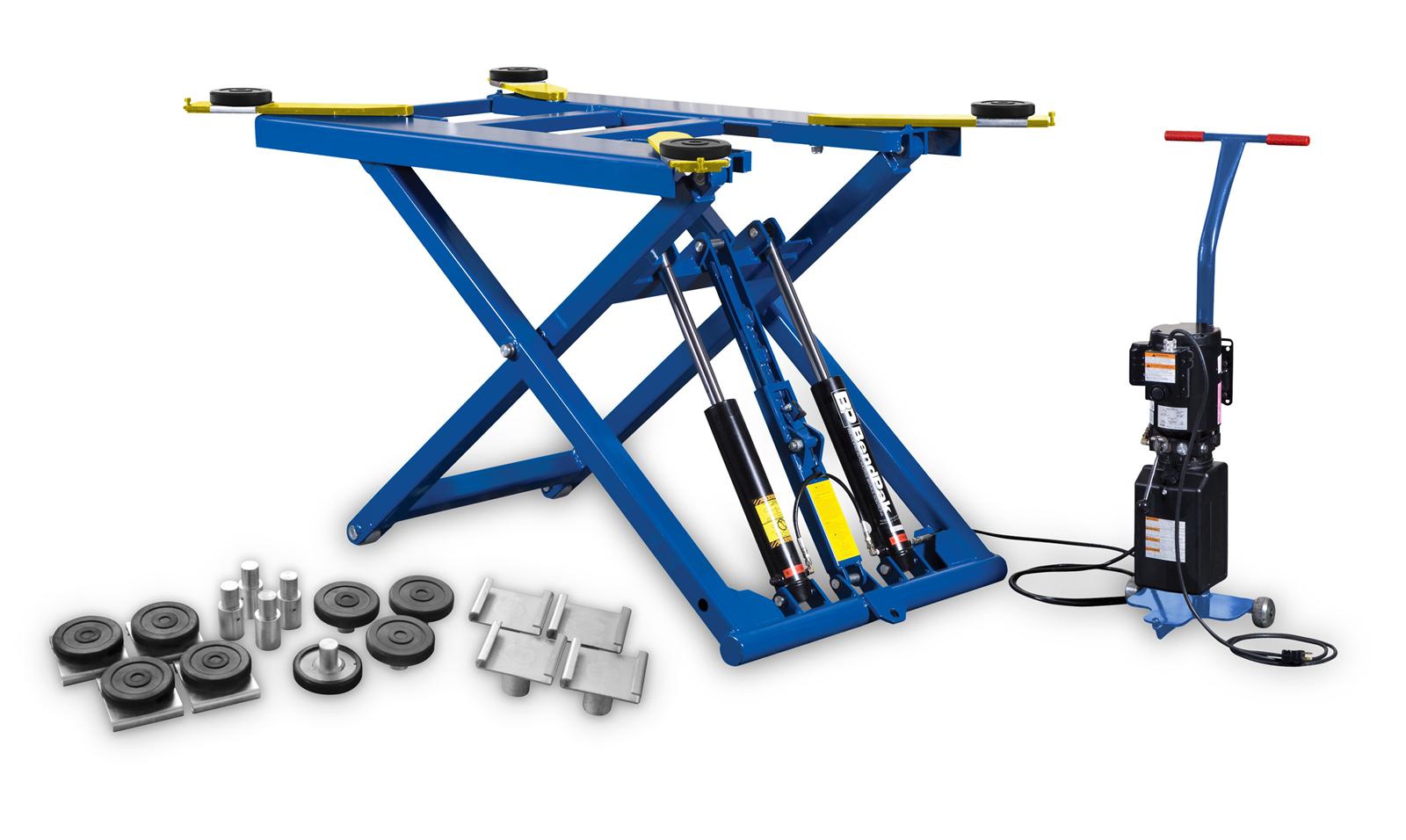

I've seen both race teams and DIY mechanics use the BendPak portable mid rise unit with great success. Big advantage is its swing arms to adjust to various cars like larger lifts and all kinds of adaptors for any project:

I would love to use one of these..... Forgot to mention above, I have no power socket in the underground either! I therefore need something that is either mechanical or that that can be used with a cordless drill to move up and down.
