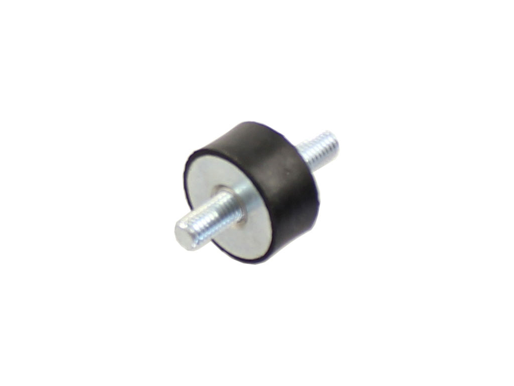

During some maintenance, I broke the "bonded rubber buffer" bolt that has threaded portions on each side of a round rubber cylinder and holds the bottom left of the throttle body. I purchased the replacement which had been superseded from 93011057901 to 99970326500. Unfortunately the new part is much longer and won't fit in the spot. Do I need to replaced the small metal bracket to match??
Here is a picture of the part I broke (rubber ripped in half)
and here is what arrived
Super glue it. Then try to pull it apart. You will be surprised how strong the glued part is.
I used to glue the engine mount isolation dampers on Norton heads with it and they never broke in the same place again.
I'll give it a try.
