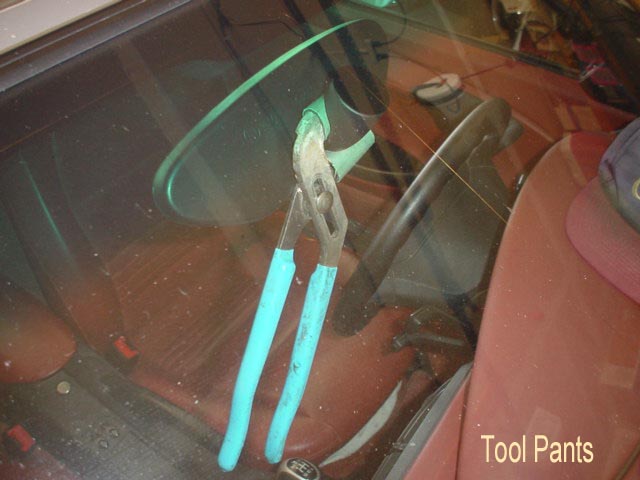

The inside mirror install is not difficult, you just have to be very careful with you remove and replace the mirror off of the windshield. The mirror is twisted off and on the mounting lug that is bonded to the windshield. Use a pair of slip nose pliers to twist it off (counterclockwise) Do this very slowly, and DO NOT pull as you twist (i.e. keep your turning motion parallel with the glass) or you will crack the windshield.

Looks like a set of vice grips? I am going to call my guy at the stealer and see what they charge for the install and I will make a decision based on that as the cost of an insurance policy against a broken windshield or airbag light.
