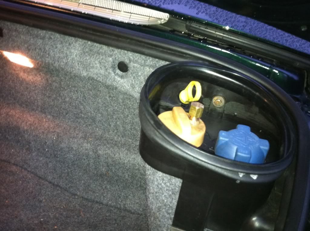

I have one of those yellow oil filler caps.  I never did like it as the seal is just a "loose" O-ring stuck in there.  Really cheap.
It's actually more orange than yellow (compared to dipstick handle).  Part # 996 107 350 52.  Should I replace this?
The replacement appears to be part # 996 107 035 52 which is black plastic with a green seal.

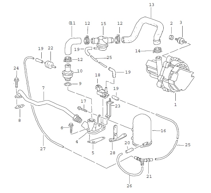

After eliminating AOS as culprit, a potential intake air leak can be caused by faulty vacuum lines (see diagram below).
Getting in there with top and front hatch removed is fiddly but doable. I have had success replacing old & brittle vacuum lines with generic vacuum tubing from your favorite auto parts store.

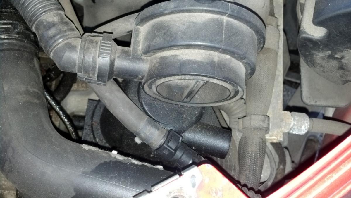

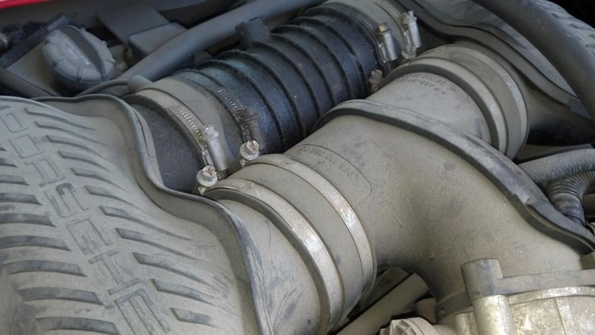

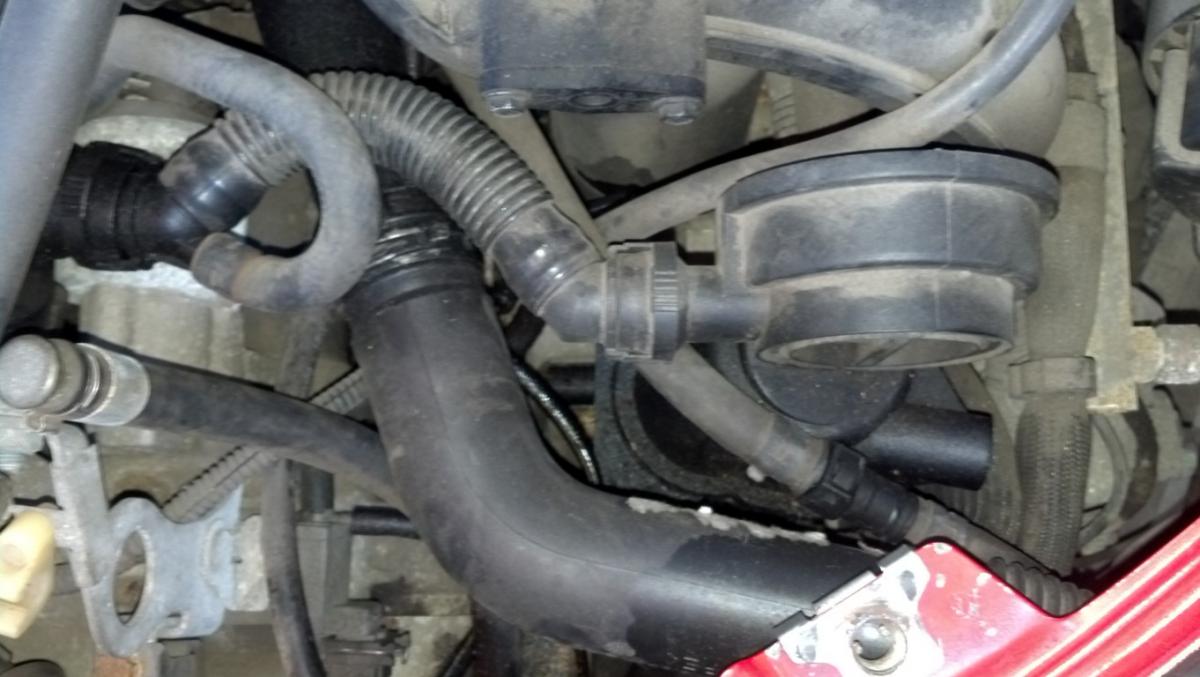

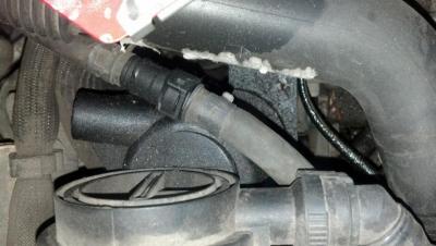

Replaced the oil cap, cleared the codes, and after 60 miles got P1126 and P1133 with pending P1130.  I noticed that when the car is cold, the revs fluctuate to the point that if I put it in gear (tiptronic) and hold the break to the point where the car slightly is able to move, the car moves in a non-uniform fashion like is moving forward and stops, moving forward and stops.  This happens only when the car is cold.
I took some pictures with some visible oil stains...is this normal and what to expect?
