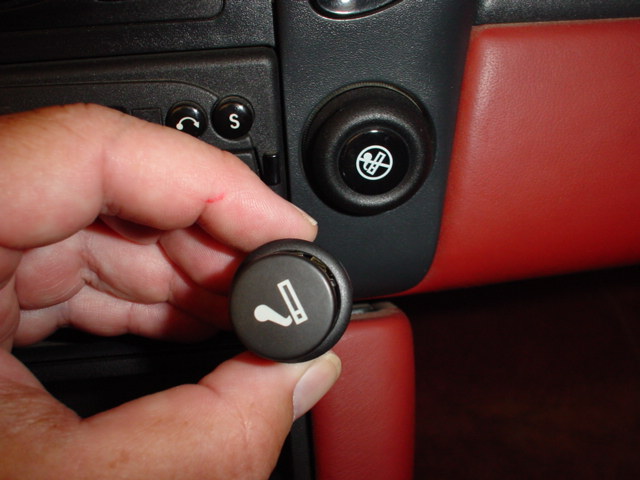

I have the non smoker socket and plug that I have never put in my car. The plug fits the original socket that came with the car. I have a 1997 Boxster. I pulled the lighter out and suck the plug in for this picture. Someone said the plug would not fit the socket on the newer cars. This made no sense to me unless the size of the socket changed over the years. I then tried my plug on a newer 996 and it fit.
Now for the trivia. On the early Boxsters the non smoker kit (plug and storage tray) was a no cost option. Then Porsche did away with the option.
Great pics TP. Looks like it can be done either way. Empty socket housing and plug or just the plug in the existing lighter socket. When I ordered my non-smokers kit I got the rear center console cubby replacment for the ash tray and also the plug with the no smoking symbol that you just place in the socket.
If given the choice I would leave the original socket in place and just insert the plug (as I did) so there is still the functionality of a power source for use (radar, compressor, etc.).
