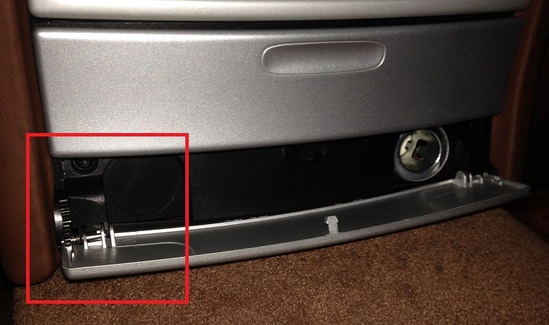

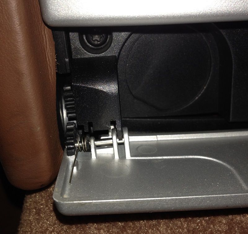

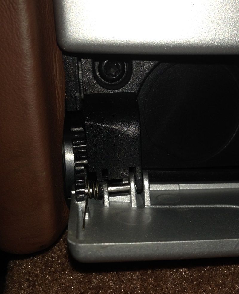

Allright, the issue typical issue with the broken rear cigarette lighter cover has struck me as well.
Any advice how to replace the broken hinge, or the complete set has to be bought for big $$$ ?

Allrighty folks, thought I write a small follow up on this topic.
In the end I ordered the part 955 552 160 01 7BA
My truck has the Aluminum package with Steel Grey interior trim.
Here is the issue, the replacement part is with a different colour. Old part on the back and new part in the front, the second problem is that the new part has two holes for the power outlets opposed to the old one with one.
As I allready had the part and couldn't return it anymore I went ahead and took the power outlet off my old cover and placed it in the new one.
In the end I just replaced my Steel grey interior cover with the new one, by pushing out the two rods which hold the hinges. Pretty easy to do IMO, just be careful not to loose the "springs" which are in the hinges.
Now I need to find the second outlet to fill the empty hole..
Anyhow, be sure to mention that you have 1 or 2 outlets, as I do not remember if I mentionet that whilst ordering the part and go the one with two holes.
