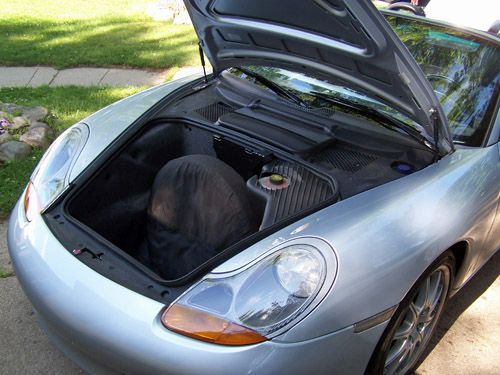

I plan to replace the Sony aftermarket radio, My preferred audio fitter/supplier want to look and see if the original amp has been removed.  I went looking for it and could not see it.  According to my brief search on google it should be near the front right wheel arch in the boot, is that correct?

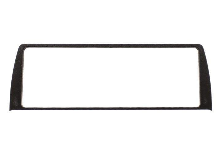

The Parrot is a double Din unit so I'm going to have to move the climate control panel.  My guess is i just remove the empty holder below the cd holder and with the brackets from its current location it should transfer easily.  Or am I assuming its easier than it should be?

You are correct that the amp is in the frunk (front trunk). It's more behind the spare wheel. Basically when you open the lid and look straight into the trunk you should see a bracket in the centre behind the spare and the amp is mounted to this bracket.

If you move the climate control to the bottom DIN, all you will need is a special face or trim plate to finish it off.  The electrical connections for the climate controls are long enough  and may need to be re-routed to fit.
Lower bezel part number is 996-552-339-00-01C less than $10.00 from Sunset Porsche.

What are your Option Codes?  Is M490 one of them? The reason I am asking is that you may not have an AMP.  The AMP is between the spare and the battery

If you do have the AMP, it means you also have door speakers which is a good thing in that the wiring is already in place and upgrading the speakers is fairly straight forward.  You'll want to upgrade the dash speakers as well as the stock (paper coned) Nokias aren't very good.
996-552-339-00-01C is only £3.64+VAT from a UK Porsche Centre.
The plastic brackets for the aircon panel are only needed for the top position in the centre console.  If you move it to the bottom position it fits the aperture without brackets.
