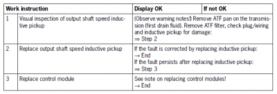

While driving home stoped to put gas drove off fine ,stop really hard at the stop light till the abs kicked in when I took off the truck took off fine 2 seconds later it felt like it's in neutral and engage and run neutral again now it not moving and I try manual mode and still nothing I tried resting the battery and it still doesn't move and I can select gears PRND selected I scanned it and got code p0721 output sensor ,I ordered the part and changed it and still I got the code and still nothing have anyone ever have similar problem or have any idea ware greatly appreciated ,THANKS IN ADVANCE post-97945-141450012443_thumb.jpg
Hey guys I finally got some time to check out the truck I checked all connectors at the tranny and they are all in good condition no corrosion and all well connected I further proceed to go under the pass seat directly at the TCU and verified all connector and all is well also and I have continuity ,I scan the car again and the same code come up p0721 ,what should I do next or what step to take ,Thanks again for the great help ,greatly appreciated
