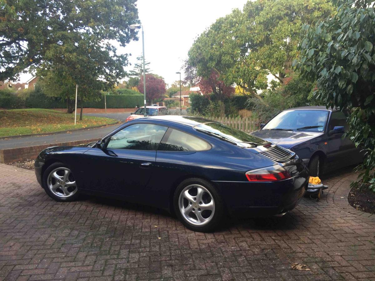

I just bout a pre-facelift 996 that is fitted with standard 17" 'technology' rims.
I'm looking at upsizing to 18", mostly because 18" tyres seem to be a lot cheaper these days than their 17" equivalents (at least, in the UK they are).  EG, a Michelin PS2 'N' in 205/50/17 costs almost £180 whereas the same tyre in 225/40/18 is £110.  That's a huge difference!
I'm hunting around for some decent 18" rims and found a nice set of original 5-spokes (pic attached) for a good price, but the fronts are 8J.  In the manual, it says 8J is for MY02 and up and for my model, the 'correct' size is 7.5J.
I've also uploaded a pic of my vehicle, 'as is', for good measure :)
Can I fit these on my car and would there be any detrimental consequences?
