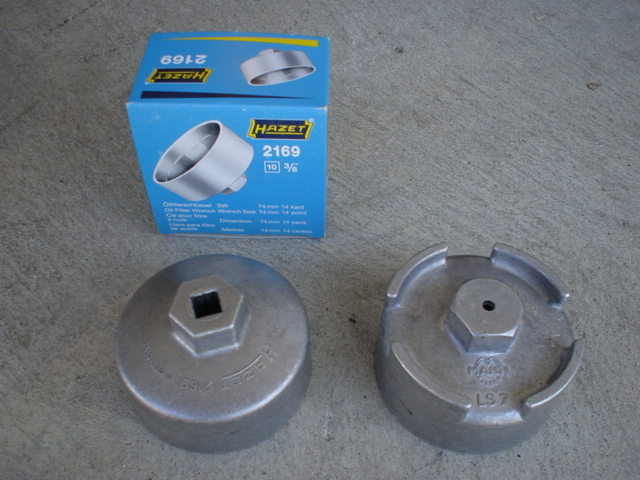

The Hazet oil filter wrench is the way to go. There are plastic versions at any auto parts place but they break or slip.
It is the one on the left, 2169. The one on the right is the one sold by Porsche that I do not like.
Just to confuse you Hazet also has a 2169-1 but it is too big.

Also the 2169 is the best oil filter wrench for these cars.... period. I think mine cost me like 16 bucks from a Cornwell dealer.
Edited by PTEC
There are many online companies that sell the wrench. You can even find them on ebay. Just search for Hazet. Go by the part number because that wrench is used on many German cars and even a BMW motorcycle. Make sure it is 2169 and not 2169-1.

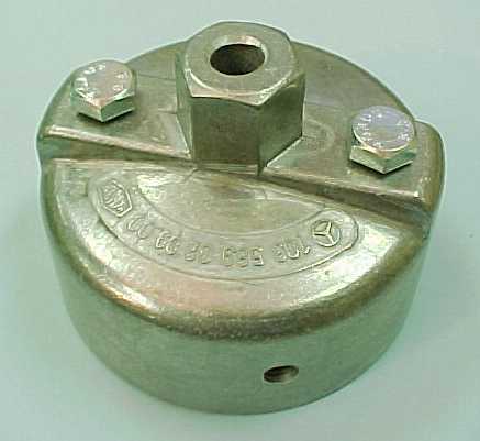

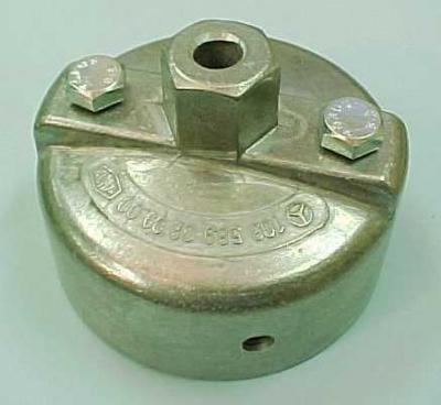

Hazet also make a wrench for a Mercedes model. This will work on a 986/987/996/997. The difference is that there are 2 bolts that are place in the side of the tool, I guess to hold the cannister/filter. When those bolts are not in use or not needed then they are stored at the top.
