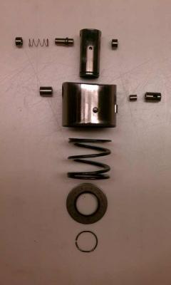

To the point, here is an exploded view of an intake lifter for our cars that I made during my efforts.  You can see there are a lot of small moving parts, one is the pin that moves laterally by way of oil pressure to lock the high lift and low lift portions together.  That happens at somewhere around 3200 RPM when VC+ kicks in, its not hard to imagine the hard life this component lives and how if one were a little less than perfect you could have some issues.  Based on having rebuilt the heads on a few other 996/997 vehicles I have seen these lifters fall apart in my hand as they were removed and yet the engine still ran OK if not a little loud and rough.  JFP I'm sure you've seen this too.
post-79395-0-96051500-1428191570_thumb.j
At the time I only found one other gentlemen in TX experiencing the same and he said:

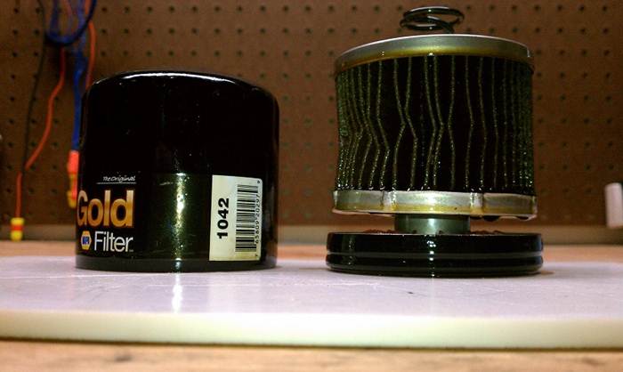

So, to isolate things better I only changed back to the factory oil filter and did nothing else except a little make up oil to replace what was lost in the oil filter change. The noise immediately got better.  I’m sure there must be tons of these adapters out there and if this is not common there must be extenuating circumstances required for it to manifest, however I’m still not sure what that is exactly.
Since my oil pressure gauge was installed after the spin on adapter was present, I had no reference oil pressure behavior with the factory system, but once I put the factory oil filter back on I immediately read about 5 psi higher cold start oil pressure at idle and even more pressure difference if you blip the throttle when it’s cold, easily passing 90 psi and still climbing. I don’t know how high it would go as I am extremely gentle on driving the car until its warm, in fact that’s a big reason I installed the gauge so I would know when the oil was fully up to temp (by way of a stabilized hot idle pressure) before driving it hard.  At cold start up the spin on oil adapter only allowed the oil pressure to reach 80 psi and wouldn't pass 85 psi if you give it throttle (with 5W-XX oil). While I'm not super concerned about the cold pressure behavior, I still saw an increase at hot idle with the factory filter, which did concern me since I’m sure the filter by-pass valve and the oil pump PRV are not open.
To respond to your other question/concern I guess the factory paper filter element (which agreed is definately not as substantially supported as the Napa Gold) does not experience collapse because:
1) there is a by-pass valve present precisely to prevent this.
2) it may have more surface area than the Napa Gold 1042 = potentially less restriction for the same oil flow
3) it may provide less filtration through a more open free flowing element = potentially less restrictive for the same oil flow
So with the LN adapter and spin on filter given the right combination of oil weight, cold temps, and enough revs you may produce enough pressure differential across the filter element to damage it since there are no provisions for relief.
From all this it was clear to me the spin on LN recommended NAPA Gold 1042 was more restrictive. So as mentioned I cut open the spin on filter I had just removed and found signs of collapse.  I imagine this occured when the oil was cold, but I can’t be sure as it never got that cold where I was living at the time, typical start up temps for me during the winter were around 45-50 F.  Its been a few years, this is the only picture I could find.

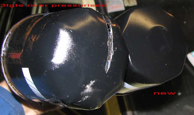

I am not at all surprised at your observed difference in cold start oil pressure with the OEM style filter vs. the full flow NAPA unit.  That is the bypass valve in operation, allowing unfiltered oil to go around the filter media.  Over the years, I have lost count of the number of OEM cartridge units we have observed with the rather flimsy bypass valve in the bottom of the housing permanently jammed open, meaning that most (if not all) of the oil is not being filtered, but generating slightly higher observed oil pressure because it is not being filtered, as there is no pressure loss across the filter media.
As for the 1042 filter photo, I would have to agree with RFM, the internal metal support structure on the 1042 is substantially thicker than the outer shell housing; so if enough excessive pressure was present to deform the internals, I would expect the thinner outer housing to also be "ballooned" from it as well:
I realize that does not explain how the obvious mechanical distortion occurred, but I do not believe it is from excessive oil pressure, which in any case would be limited by the relief valve on the oil pump.

As for you lifter observations, yes, we have seen very much the same thing, but with one additional observation:  Both the VarioCam and VarioCam + system lifters are an oil passage "dead end" design (read there is no oil flow through the lifter to clean it, it enters the lifter and simply stops, leaving behind very old and dirty oil, varnish and any debris circulating within the oil system).  This has always been considered a limitation of this design.  It is not unusual to remove the lifters from an otherwise internally clean engine that when placed in a bath of clean thin oil and then pumped by hand immediately puke out some very black and foul smelling ugly crud.  This burnt and fouled oil is the reason that these lifters develop problems, including internal wear that allows them to simply fall apart when removed, much like the burnt oil often found trapped in the IMS bearings when the rear seal is removed.  Considering the dead end design, it is not at all surprising that some people have found that running thinner oil helps with the noise, but unfortunately does not offer the high temperature/ high shear protection of a higher weight oil.  It also explains why some engines that are quiet at cold start, when the oil is thin, become more noisy as the oil thickens with temperature.
I realize that does not explain how the obvious mechanical distortion occurred, but I do not believe it is from excessive oil pressure.
Nice one!  What filter is that and what total system pressure caused that level of damage to the casing?  Does that filter have the bypass valve built into it or is it in the block of the car engine like many cars?
Second, the filter casing sees the maximum total pressure in the system whereas if the filter bypass valve is sized adequately it can keep the pressure differential across the element low enough to prevent damage to it (once again that's pretty much its job).  This is why you can split a filter canister open or blow out its seals and the element may still look OK.  The critical difference between the above and our situation is the Napa Gold 1042 has no internal bypass valve, and our engine block does not have it either (because its built into the bottom of the factory reuasble plastic filter housing) so by using the spin on adapter you have changed the base system.  So I believe its possible in this condition to produce enough oil flow (presumably at cold oil temps) to create a pressure differential across the filter to hurt it all while the total system pressure remains low enough that the outer casing does not deform or fail.  I don't have the data to prove it explicity, but I believe its easily plausible.

Agreed the lifters are a dead end design, but they still require a non-zero flow rate to operate properly.  They all experience some small amount of leak down in operation and when sitting with the engine off.  The switchable lifters on the intake side even more so because the lock pin is dependent on oil to actuate.

The ballooned filter is a similar NAPA Gold unit that was on an LS engine in a Corvette.  The final pressure was unknown as it destroyed the pressure gauge as well as the filter and several other seals in the engine.  But interestingly, the filter's internals were fine, just the shell was ballooned.  As to your question about bypass mounted elsewhere, total non bypass engines are fairly common these days in several domestic and most Asian vehicles.  With modern synthetics, the severe high cold oil pressures are pretty much a thing of the past, and the OEM's are quick to remove anything the engine does not need in order to save money, even a fifty cent plastic bypass valve.
I realize this may not seem so, but this supports what I wrote above as to how one can easily destroy the casing without hurting the filter media when a oil filter bypass valve is present, which to my knowledge the LS engines have in their block.  It does not mean the opposite can't be true when a oil filter bypass valve is not present.
