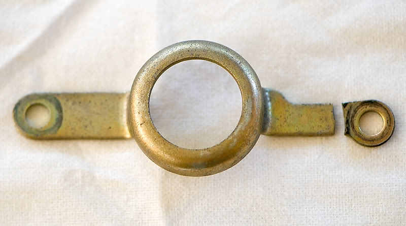

OK.  P1371 is a generic code for a failure in the valve lift control system, and P1361 is for valve lift control failure on cylinder #2.   I've only seen this error once, and it was when the bracket holding the valve lift control solenoid on the bank failed:
While a bit of a pain in the butt to get to, there is no way this should cost $6-20K to repair.  The bracket is only a few bucks, but they may have to lower the engine to get at it.  Even if the entire solenoid has to be replaced, it still is not that expensive an item.
