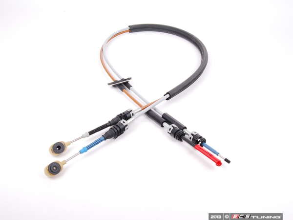

The cables set is a bit over $400 alone, and I believe it is about 4-5 hours to change them out (it is not hard, but you need to pull the car's interior apart to get at the inside bits, lower the front of the engine, and then route the cables through the rear bulkhead to the gear box as they are one piece).  The job is more aggravation and time consuming than hard.
... lower the front of the engine...
That's the bit that concerns me.  Is it like my 911 where it's basically 2 bolts and support the engine on a jack?
Any opinions on the Numeric cables and SSK.  I promised myself I was going to leave this car stock, but if I have to get in there and replace stuff, I might as well go for a mild upgrade :)
Yes on the front engine mount.
The after market (Numeric & SSK) cables have a lot more metal in them than the OEM does, which tends to make them much more durable and somewhat improves the shifter feel, but that move away from plastics decreases sound isolation a bit and some have complained that while the shift feels better, they are getting noise transmitted into the cabin; so they can have some trade offs.
