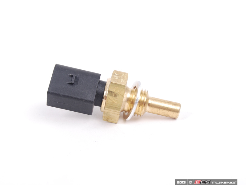

I'm about to order a coolant temperature sensor (part# 99660641000)

will check the water pump when I get home. As for the sensor, I ordered it from ecs, it's part 99660641000, and I hope that is the latest version. In the pictures it looks like the o-ring is included and the retaining clip would be the plastic part on the left..?
