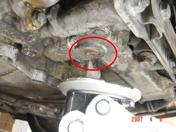

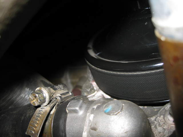

Any thoughts on how dried coolant on a drain plug at the water pump equates to impending failure?
There are two "drains" on the cooling system, one is an actual plug (photo below) and the other is a "weep hole" which is beneath the water pump pulley itself.  If a "crust" develops from leakge at the weep hole drain (second photo), the seal and bearing in the water pump are failing and need to be replaced.

Armed with JFP's pics I had a look under the car while it was in for an oil change. Sure enough minimal dried pink crust around the drain plug. No more worries. Gonna drive it like I stole it at the track.
