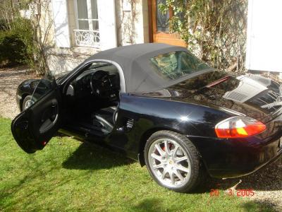

ps: i am off to try to post some pictures of my car now (if i can find how to do it!).
