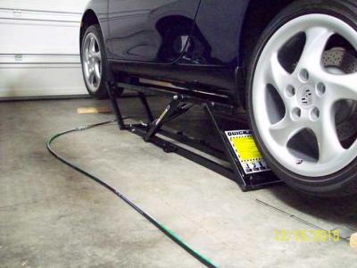

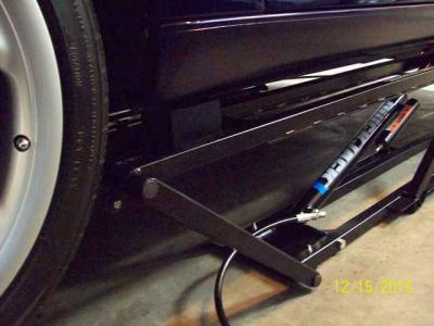

After researching scissor lifts for my 996 with limited garage space I decided to go with the Quickjack 5000xl.  The "xl" means the length is extended so that the lift pads will line up with the jack points on the car.  The standard 3500 and 5000 models are not long enough.
It arrived well packed, no damage, pretty easy assembly, and decent instructions.

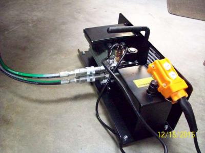

Nice little hydraulic power unit with good quick-disconnect hose fittings that don't leak.
Only issue was that one of the long extension hoses was not crimped properly and would it would not allow any oil flow.  Only one side would raise up!  Rather than wait for a new set (of VERY cheap low quality hoses) to be shipped I went to my local hydraulic hose shop and had them make up 2 really nice flexible Gates (USA) hoses.  That solved the problem and the lift works well.
One advantage of this type of scissor lift is that there are no cross-members so nothing underneath the car is obstructed.

How high does it lift?
Do you think it is ok to use to keep a car lifted for extended periods of time  (using the locking bar of course)?
I'd be circumspect about leaving the car with the suspension hanging for long periods.  Porsche actually had a TSB recommending against doing this.  It is one thing to leave the car in the air while working on it, another to store it in that position.
