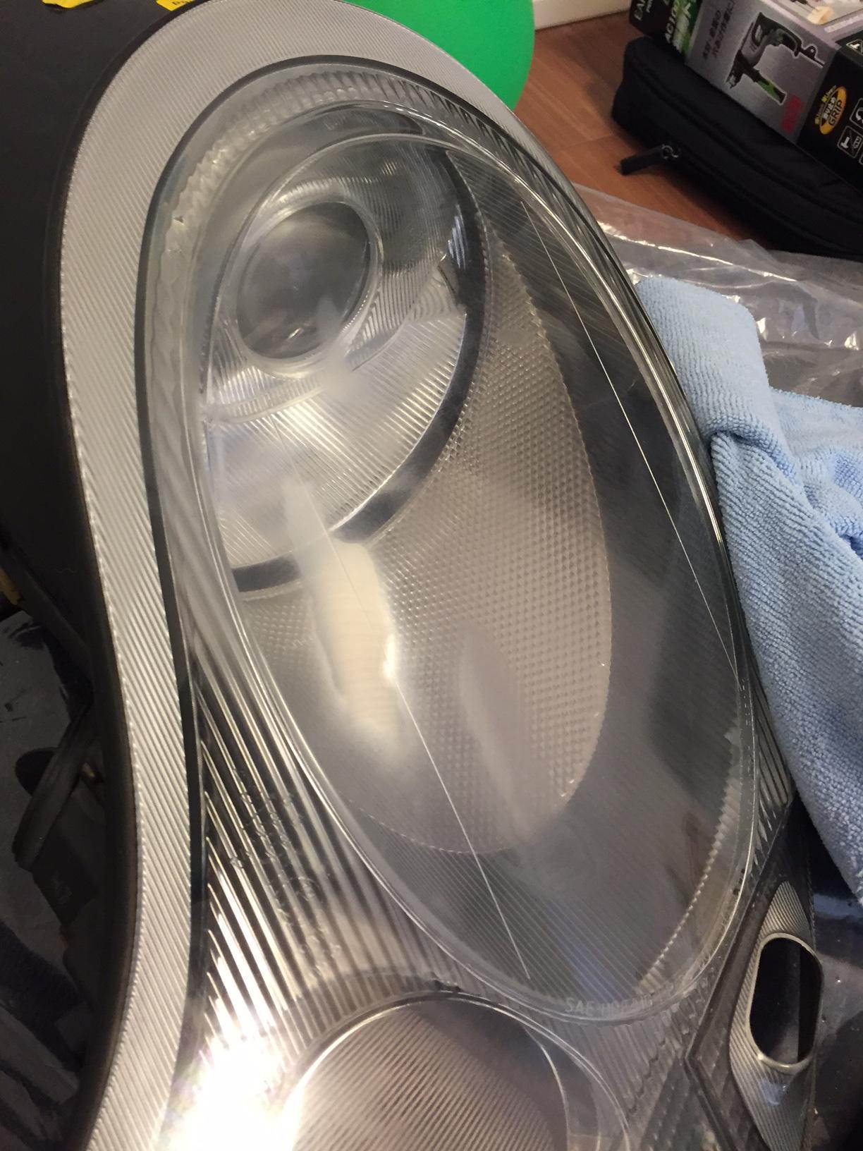

Hi all,
So I'm trying to restore my headlight using the 3M restorer, except I think I'm going from bad to worse. I first tried with a random orbiter and the P500 discs, but that didn't go so well - I scratched up the lens more than I restored it. So I aborted and restarted using a drill. But I have these "hot spots" on the lens that I just can't seem to get rid of (see picture). What am I doing wrong? I am running at the prescribed 1,200 rpm or so (my drill has a speed limiter, is a 2,400 rpm max drill, and I have it set at about 50%). I am not exercising excessive pressure. I'm also making sure I don't stay in one spot for too long a time (if I had to describe my process, a single pass takes me about 3 seconds from one end of the lens to the other). The lens doesn't really "frost up" as 3M shows, and overall, the process doesn't seem to be quite working - and my headlight is progressively getting worse. :blush:
Any advice, or should I start shopping for a new headlight?
I think you will be OK.  It appears that your problem may be that you haven't totally removed the existing UV outer coating. I used a combination of the Sylvania and 3M kits when I restored my headlights.  The advantages of the Sylvania kit are that it includes a solution that removes the existing UV layer which makes the headlight easier to sand and it has a protective coating that you put on at the end that smooths the surface and makes it shine.  I liked the 3M kit because it had the drill attachment.

Thanks. What's throwing me off is the lens won't cloud or become frosty at all, no matter how much I sand it ... maybe I need a stronger grit sandpaper?... I've gone over it a number of times with the P500, and it hasn't begun to frost up at all except for a few places.

In my case, I'm wondering if I should go to a 400, since the 500 is doing absolutely nothing. Did you water the lens at every step? I'm not watering it at all, since the 3M manual never tells me to do it, but it seems like some people are recommending it?...
I think you missed the part in KevinH90s where he noted that the Sylvania kit includes a solvent for the existing coating.  Worked like a champ for me.
Ahh yeah I did miss that. Guess I have to find a way to source that kit in Japan ... I think I should stop all work on the headlight as is and try to get the Sylvania kit, see how that goes.
It has been a while since I did my project.  I think I may have wet sanded when I was using the very fine grits.
As Rockhouse suggests, try to obtain the Sylvania solvent before you become too aggressive with the sanding.
