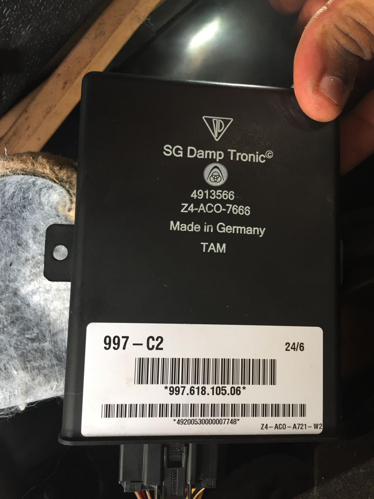

I just got a 2007 Carrera S Cabriolet. I have inspected the strut and can see the wire coming out of it into the car.  I also have the SG Damp tronic control unit at the top right corner of the passenger side foot stairwell.

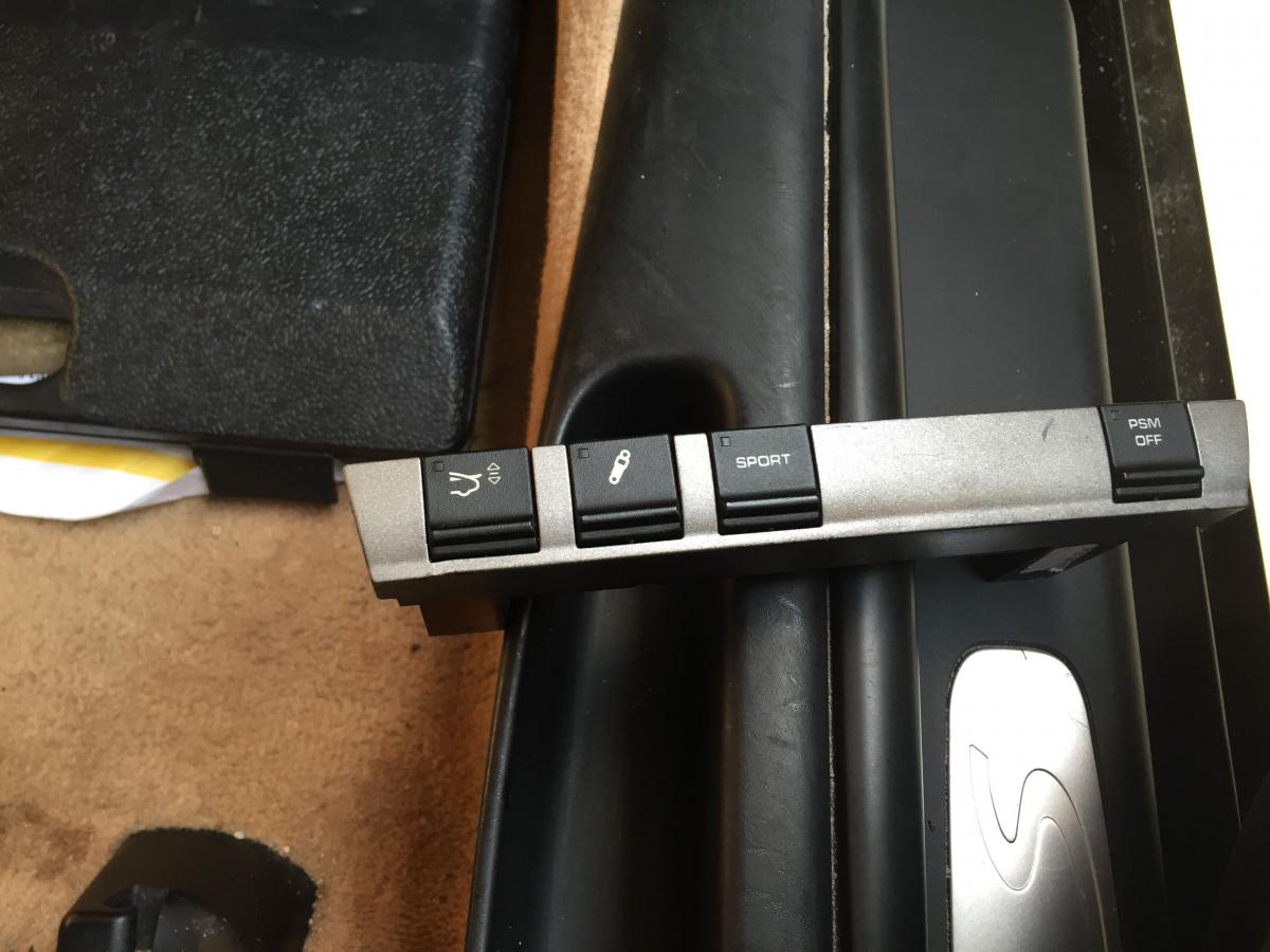

Now the issue I have is this: I tried to press the sport button on the centre console but it wont work. No lights at all! I also noticed I cant manual raise or lower the spoiler. But the spoiler works cos it came up some time ago.
I then checked behind the combination switch and I didnt find ANY wiring attached to it!! Nothing at all. Just the plastic with the buttons!

I have tried to run a computer on the car and it gave an error code "0010 LED Button" as an error in the PASM menu.
If this situation is possible, could it just be that the shocks/dampers are just tired and just need changing!! Is it possible to get new wiring harness and activate the sport buttons. Pics attached.

The button modules are specific to the options fitted to the car, and I think it unlikely they have been changed. Especially if the spoiler was working on the button, and now isn't. There will only be one connector to the button module - you won't see wires for each button.
Probably not easy in your location, but it sounds like you need someone with a PIWIS to do a diagnostic check, and run the Handover Routine. This restores any settings that are commonly lost after a battery change.
