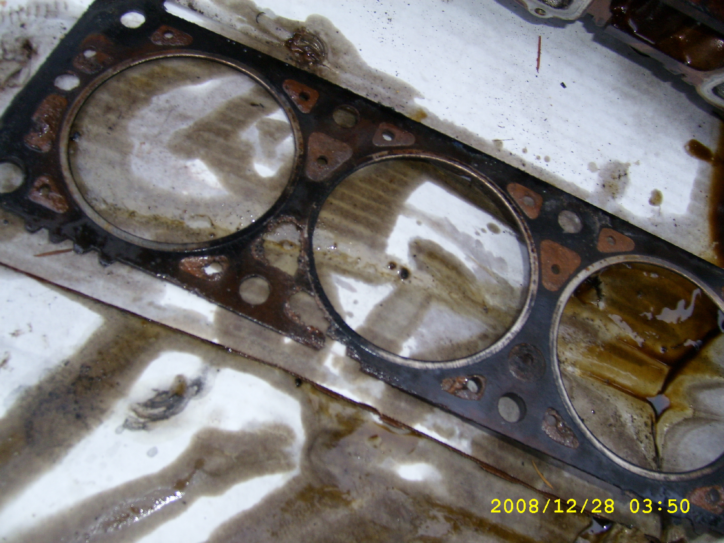

Since it was formulated without the addition of silicates (the corrosion inhibitors in green antifreeze) a different corrosion inhibitor strategy was needed. Organic Acid Technology or OAT is the inhibitor part of dex-cool. Unfortunately, the dex-cool is capable a rather nasty breakdown. The residue it leaves behind is very sticky, and likes to find areas in the engine and other areas to "drop out" or "fall out " of solution and stick to the wall surface of engine and radiator.
In many cases, the orange mud hardens, and seems to expand or push the gasketed surfaces out of position, causing leaks.

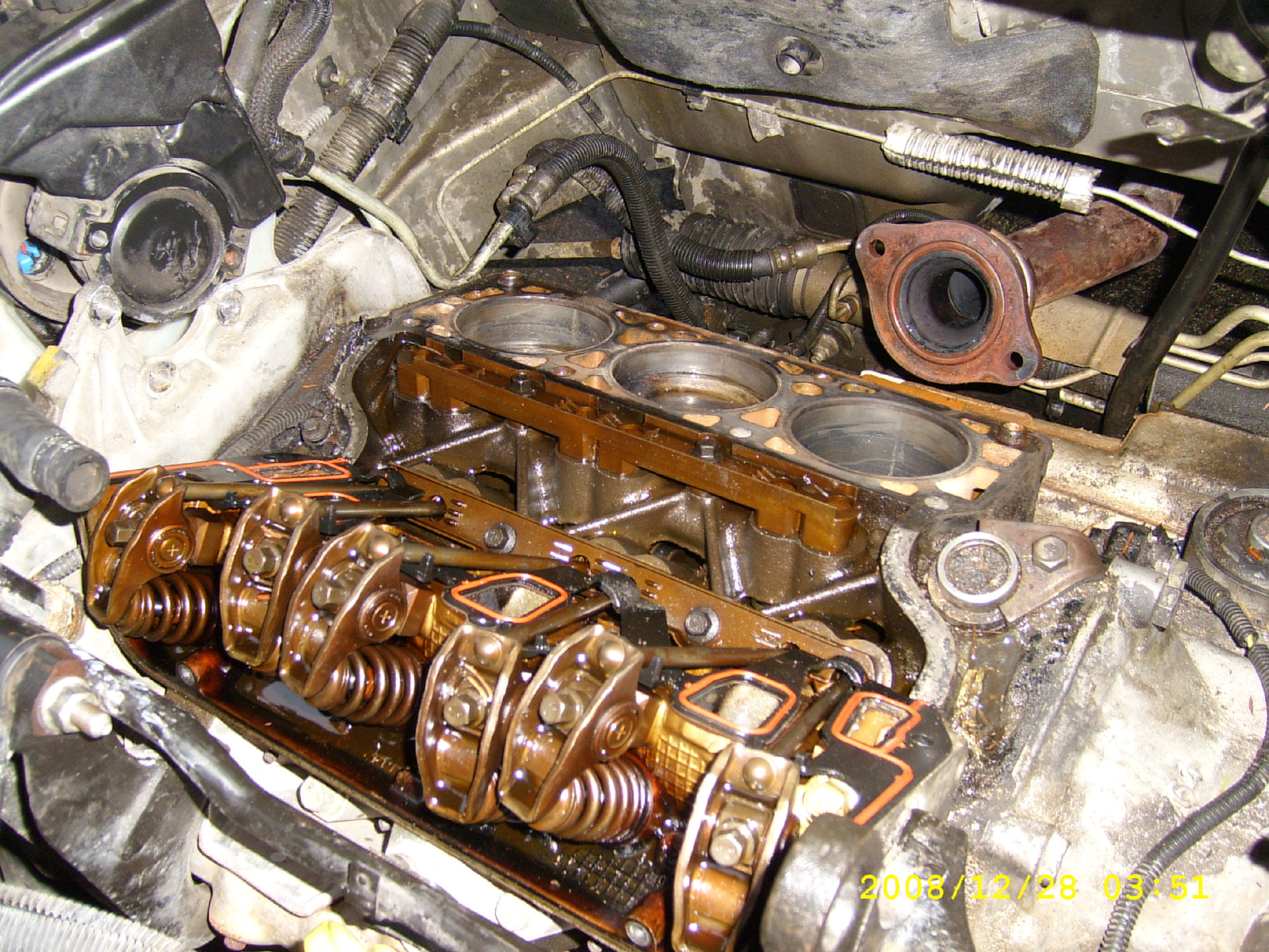

My Chevy 3.4was filled with DEXcool for a couple of years,,,and the result was waisting 4 precious HRS(just hate to work on a chevy)last Sat day for complete tear down
