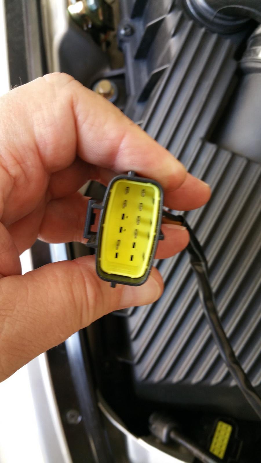

The upper left two pins have resistance to each other. These two pins are to the wires that I don't know where they run to.
The upper right two pins have resistance to each other. These two wires run to the fan.
The lower right to pins have resistance to each other. These two wires run to the light.

I've been corresponding with another factory-installed aero kit owner. He has 7 wires coming out of his connector whereas I only have 6.
If you still have your aero kit 996, is there any chance you could take a look and see how many wires are coming out of your connector?
Thanks again.

As I said you may have the wrong harness - either from a repair or accident.
Mine also has 7 pins/wires.

Ok thanks for taking a look.
I guess I'll just have to continue scratching my head as my harness is clearly missing a wire. Plus I've noticed that the wing has all of the markings of an OEM piece (imbedded PD and Turnwald lettering, not a sticker) but it is missing the "Made In France" lettering next to it. The car has all of the other factory stickers under the lid and is a '99 but was built in October 1998. I'm wondering if it that could make a difference? Additionally, the car has "XAA" on the underhood sticker.

Update: I was able to take extra length of wire from the #2 and #5 connector wires to create my own wire for the seventh one that I was missing. I then fabricated a connector pin from a computer cable and attached it to the new wire, soldered the wire ends of those three wires together, and got the new pin to seat in the connector assembly. Put it all back together, got the car up to 80 mph and no more spoiler warning light. Fixed!

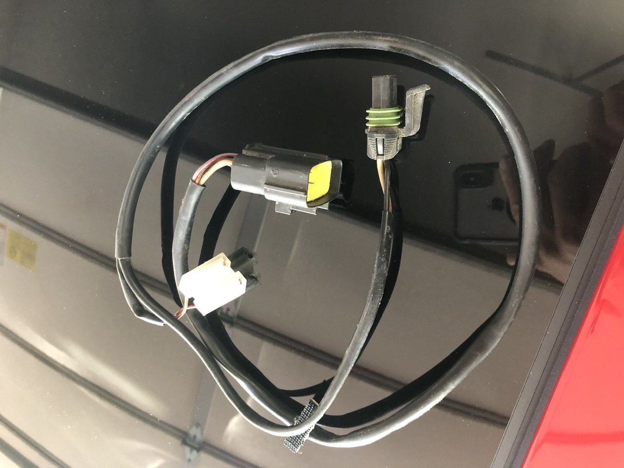

Hi Loren,
Great advice here - hoping you can help out and I will write up the procedure in a post later.
I have a 2001 UK spec C4 and I notice on the wiring diagrams that the USA spec has a different wiring diagram. Would you have a diagram for my car?
I have purchased an aftermarket turbo fixed wing in GRP as per the attached (this is the car it came off not mine) and it comes with a standard movable wing harness. The power and return for the spoiler power (red and black) mentioned in an earlier post have been taped up and the three microswitches have been zip tied, leaving the 4th brake light, fan and work light intact. Basically, I want to be able to take my stock lid off and leave it unmolested then modify the harness on the fixed wing to mimic 996.612.070.04 (because my fixed wing has a 4th brake light). I have done some tracing of wires but want to be sure. Any diagrams of the fixed wing harness would be good too.
Many thanks in anticipation.
