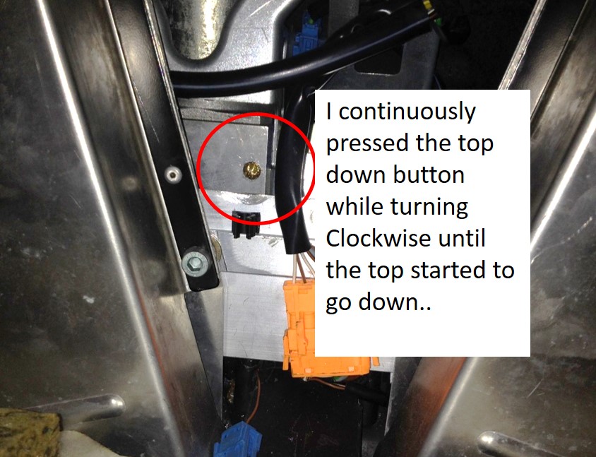

I had a similar issue with my cabriolet.  Have you tried adjusting the brass hex head fitting on the cab controller?  The attached picture is the area of focus.  I had to turn the brass head clockwise about a 1/4" for my top to catch and go down.  This is looking from inside the cab toward the back of the car.  The two silver things in the foreground are the rollover protection canisters.

Hobbes. Tried this but it did not help. I have now checked all 9 microswitches and reset/ checked both petentiometers and reset the latches at the windshield. Still no luck. I had a voltage meter on the leads to the hydraulic pump and there is no power being fed to it. Once the clamshell is open and the latch is open I hear a click and the in a few seconds another click, but no power to the pump. My next shot is to switch out the cab control module with one from a friends car that we know works. If that fixes the problem I will know the control module failed. If not I am not sure what I will try next.
