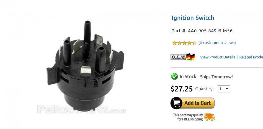

I appreciate the advice, but 13 years of service seems to me a good bet that the new switch will outlast the boxster. If not I will happily put in a second
I've attached a screen capture from Pelican. This is the right part, no?
Thanks for all  your help. Glad that It was such a cheap fix, hope the new parts get here before the switch gets any worse
Well Porsche of Rockville didn't carry the part, they only carried the entire assembly (which I assume is the improved part), but it was $270 so Pelican it is
Thanks for your help. The wait for delivery gives me time to practice my yoga in anticipation of crawling under the dash
