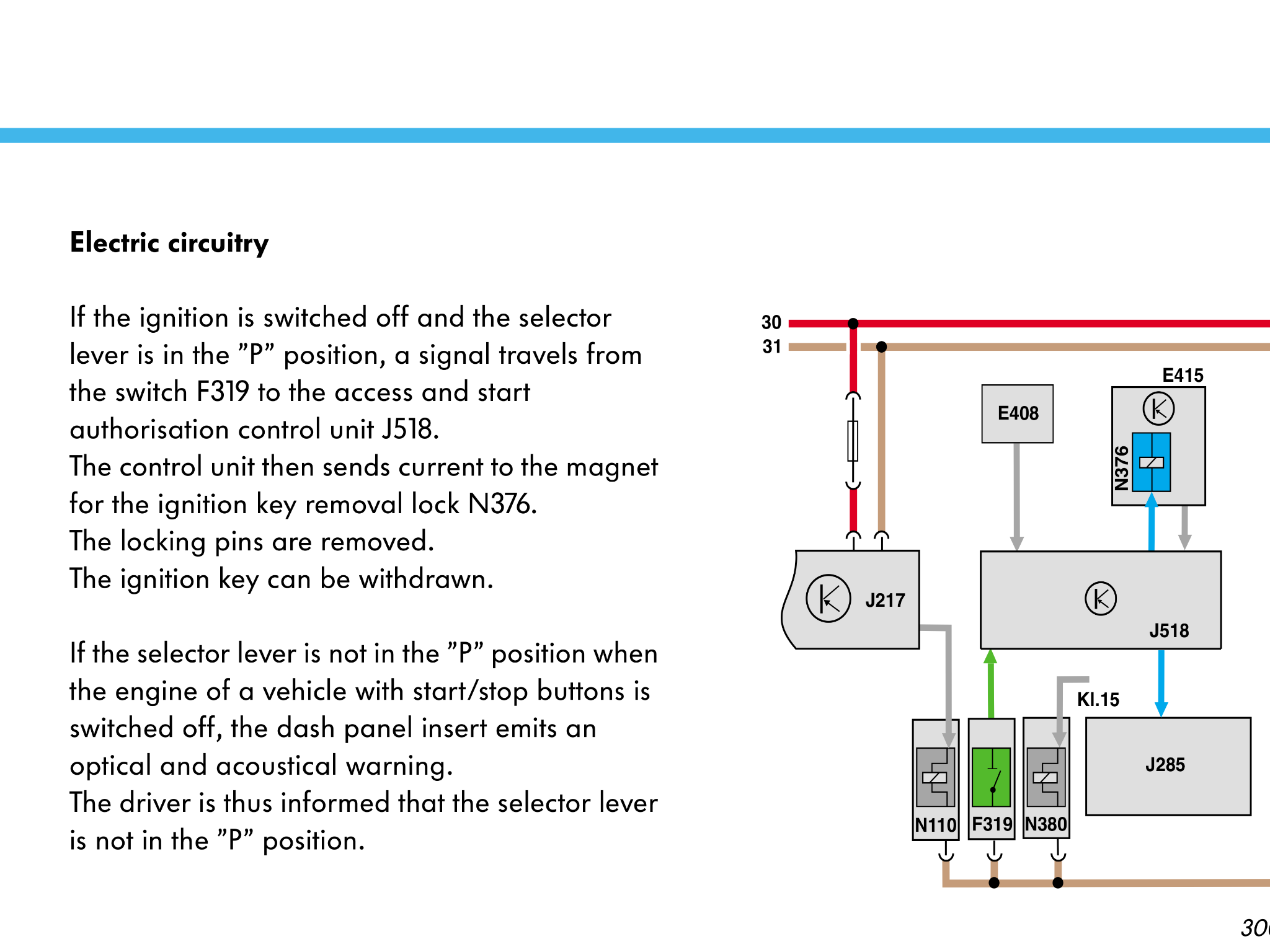

according some forum members i need to check the wiring under passenger carpet for broken or bad wires.
There is also a micro switch on the shifter assembly that senses when the shift lever is not in Park position.
It too can cause the message to display and prevent the key being removed when engine off.
Part number is 955-613-043-00
