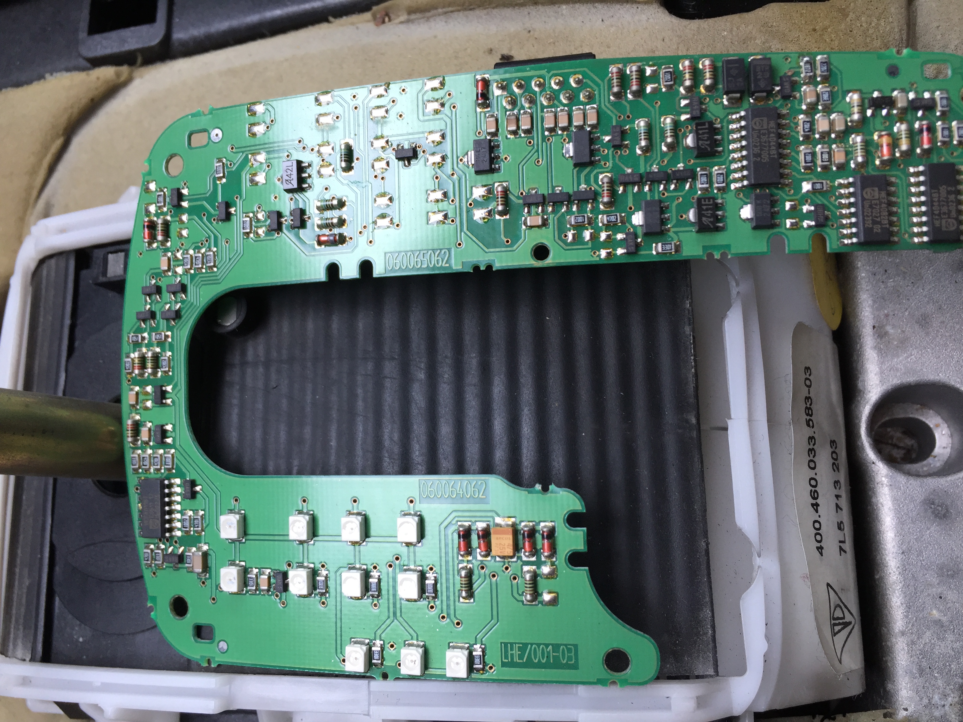

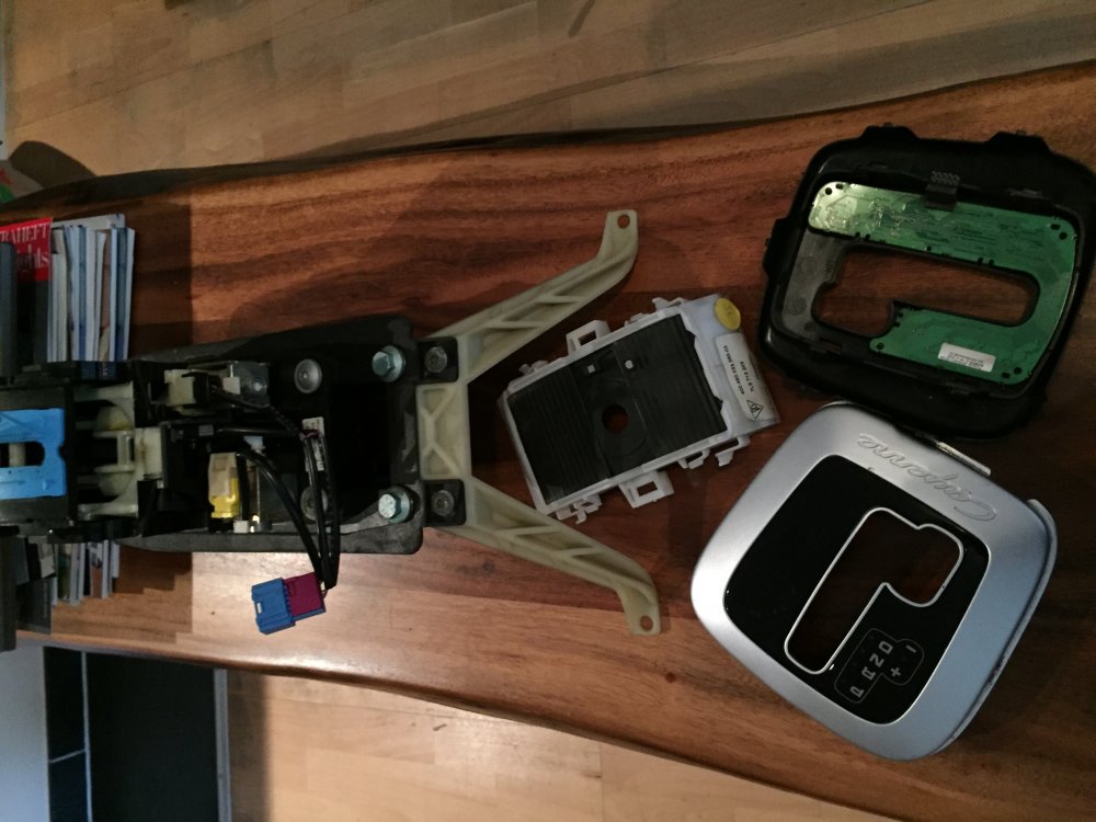

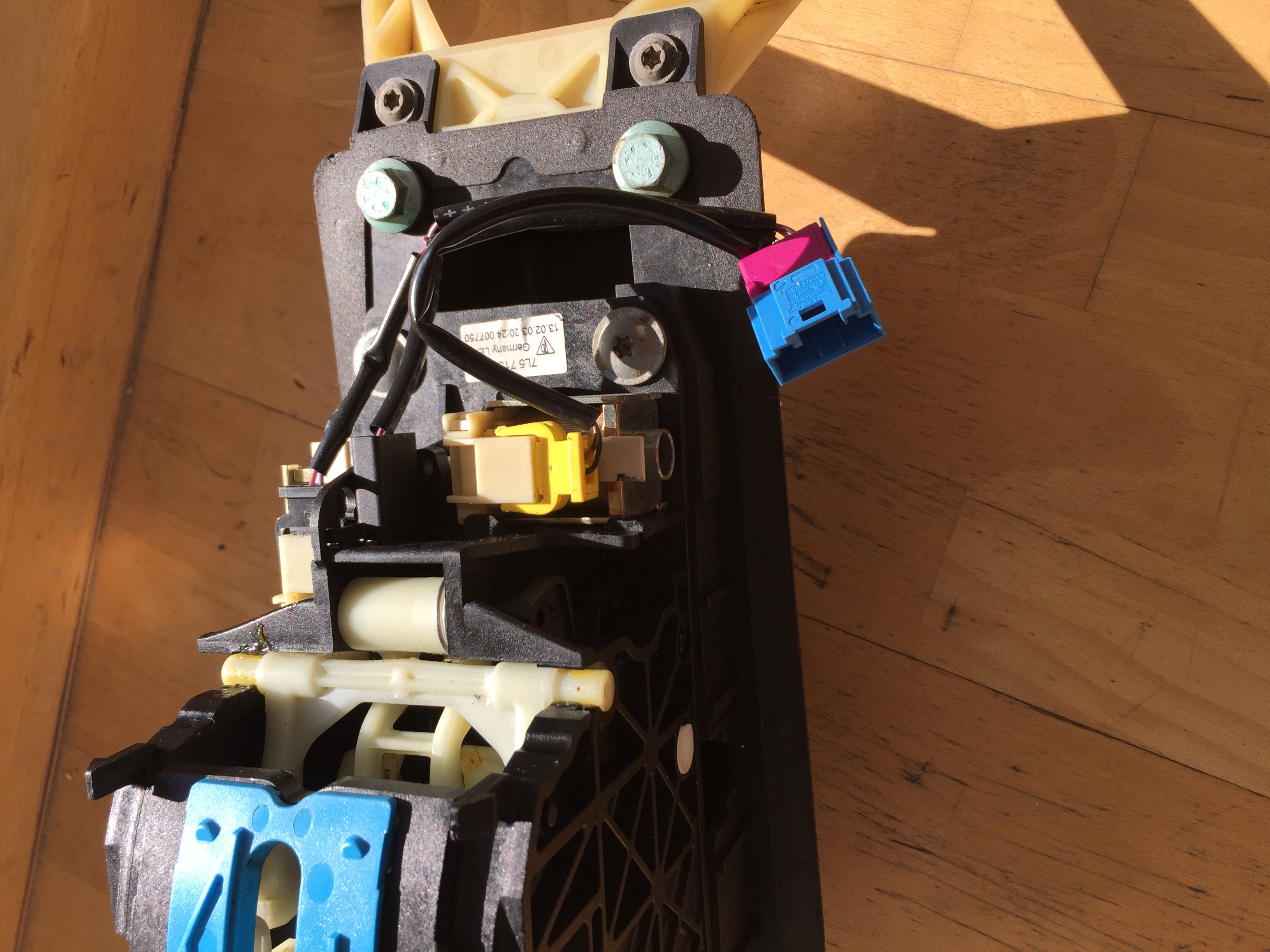

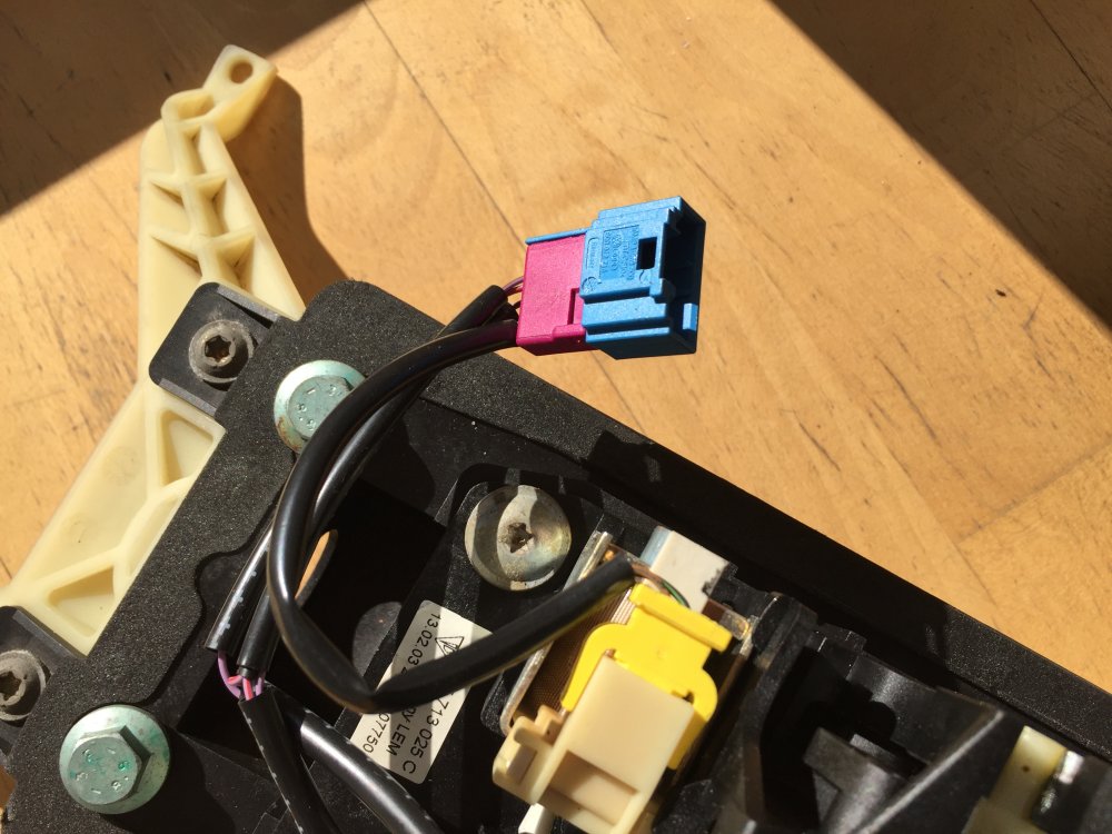

I have a old CS which was on the street without driving for more than 2 years (scored cylinder). I am going to try to put him to life again.
After having a new battery and clearing all codes i one problem is remaining.
the shifter works well but when i want to stop the car and put shifter in P the display is showing "put shifter into P positon".
key is not removing. Only after some wiggle.
According some other forum information i disconnected the assembly. Changed everything and replaced. No change. Still the same message on the display.
Interesting is if i leave the green board out if the assembly there is no message and the click and key is coming out like it has to be.
i checked the wiring under the carpets but couldnt see anything strange.
whereelse i could check for this problem?

I remove the circuitboard but now I have a few other problems. The trip tonic does not work from the gearbox on the steering wheel, after about 30 minutes of driving the display get stuck on D and it will not show what a switch to other gears including neutral, reverse, and park. Additionally, now there are no lights in the gearbox
Guys it's the magnet position in relation to the circuit board I think. Either the magnet distance is too far from the circuit board inductive sensor or the magnet is weak and that plastic bit black cover piece needs to be changed. Maybe after years of use the Plastic sags alittle down and too far away from the circuit board?
Also possible is the pin on the board that plug into the connector are not making proper contact but unlikely.
Try to get another magnet from somewhere and run it manual under or over the circuit board to test the board is functioning. If that works then you know the board is not the issue as thomas found with his new board.

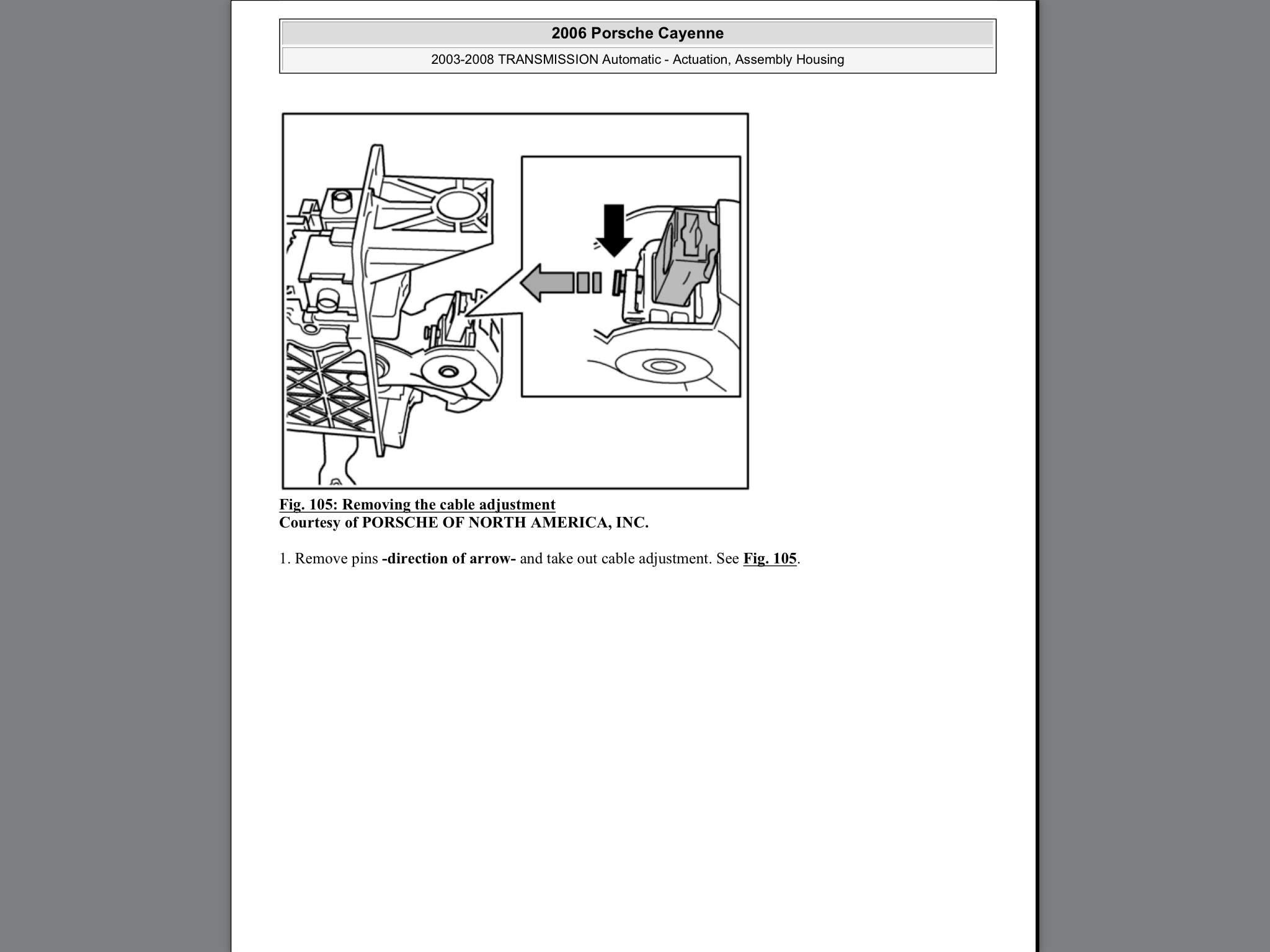

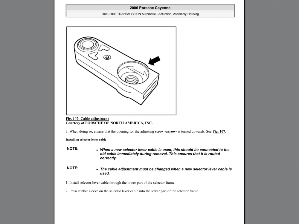

Check the cable that runs from the lever to the transmission mode switch on the transmission.
I've read that the cable may stretch and not position the mode switch correctly down on the transmission.
It may be possible to remove the slack in the cable by adjustment as per link below.
http://rennlist.com/forums/porsche-cayenne-forum/861420-move-selector-lever-to-position-p-fault.html#post12940606
Edited by bigbuzuki
Thank you for this post. Are we talking about this cable with the BLUE head?

1 hour ago, bigbuzuki said:
This the cable at the transmission end.
If the tranny is switching to the P position, there is nothing wrong with the cable.
