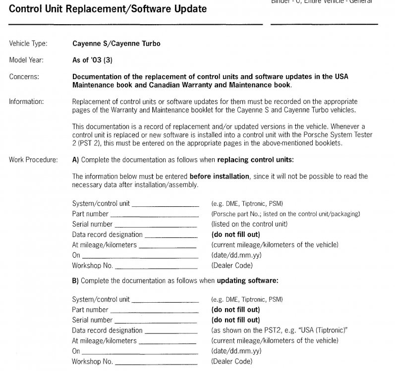

Thanks Loren... good to know that there is just one part number for both sides... means I can swap them for testing...  currently passenger side low beam not working.  Drivers side is good.  I am afraid though if I swap the headlight control unit that some wiring fault on the left side may fry the good unit out.
Not to rush you, but do you know the answer to the second question regarding PIWIS and the headlight control unit?  I am on the west coast too and fortunately its a quiet evening for me... thank you.
