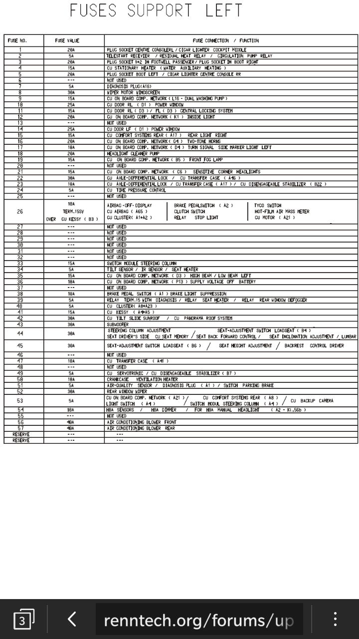

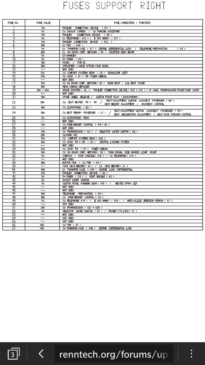

Try checking some fuses.
Left side fuse panel number 16 and 42
Right side panel fuses 36 and 42.
