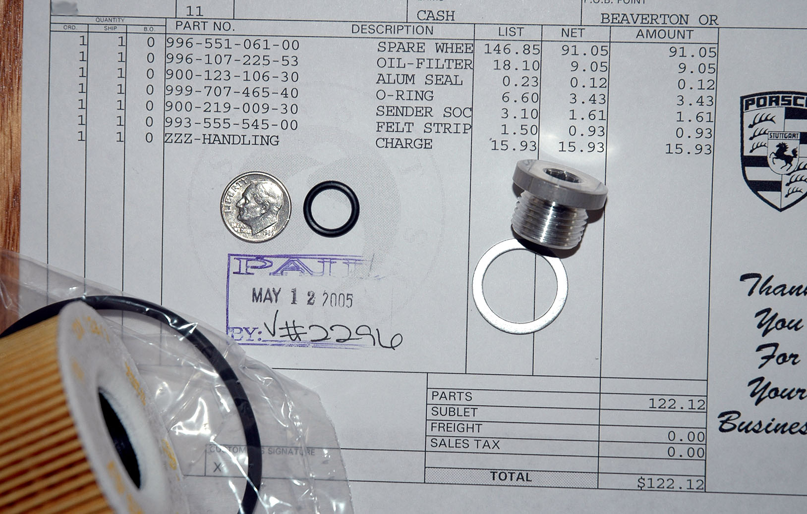

Old Scandahovian saying: One Picture Worth a Thousand Words...check the neo o-ring next to the dime...BTW also check the price for the oild filter...from Jeff at Sunset...post-3706-1116010075_thumb.jpg
Jim there are two "rings" you need.  One is metal about the size of a penny and goes on the oil drain plug.  The other is a rubber (like the one in the picture above) that goes on the filter cover.  The rubber one for the cover should be in the filter box, and the metal ring should be taped to the top of the box.

Hi Loren...
That was the p/n for the drain screw (my goof) I bought a new one. But check out picture and invoice above...
