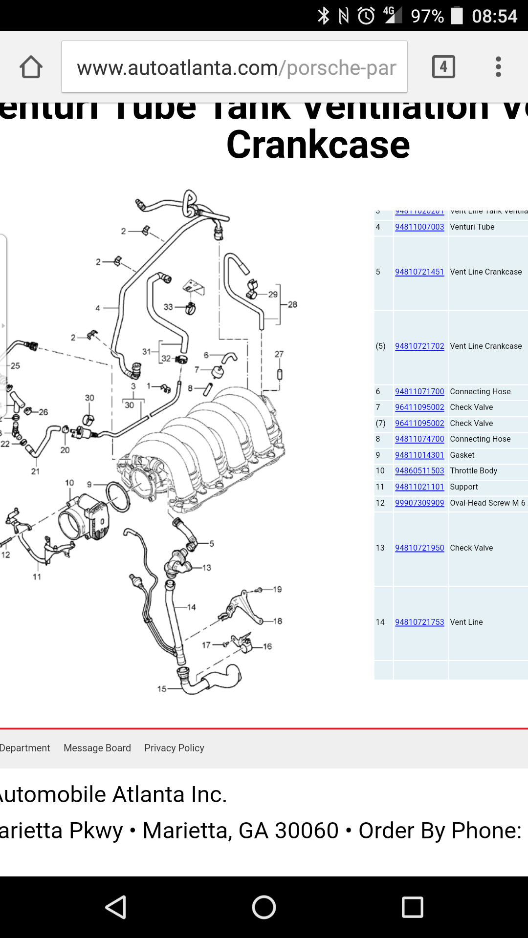

Assuming you haven't had the manifold off, the list of top likely leaks for me is:
1. AOS
2. Pipes 4, 5, 14
3 throttle body dirty and or gasket 9 leaking
4 Check valve 13 leaking or 25 or small pipe from 14 all are check valves.
The fact you have to modulate the throttle to keep running after cold start has kicked off suggests to me it a dirty throttle butterfly. Easy to remove and gasket is cheap. Also check the pipe under it for damage splits and check the two small black check valves working as they should. (Arrow tells you the flow direction, reverse flow should be closed)

Aos good. Pulled and checked no tears or anything suspicious with it.  Pulled all lines you referred to and blow tested the check valves. All seem to be in order.  Cleaned throttle body and checked for signs of leakage around the throttle body to intake manifold mount for soot or any signs of leaks without pulling it.  No one around has a gasket in stock today so didn't want to pull it.   I'm going to reassemble and start it up to see if any changes. I'm leaving cool pack covers off so I will have easier access to them.
Is there a master o ring kit for all the major boost pipes?  All rubber couplers are good and have been checked but I'm thinking maybe those o rings go bad?  Torque mount has some crackage some maybe excess motor flex caused some to have a poor seat?

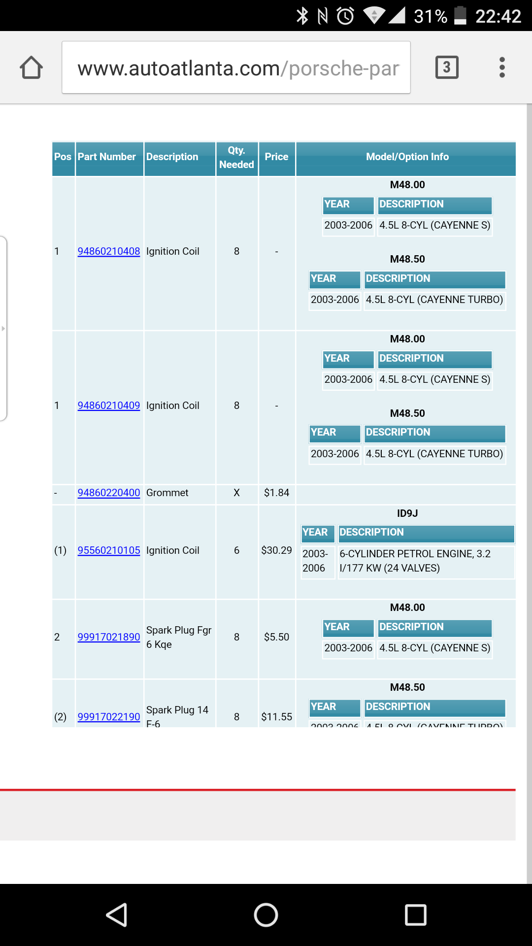

The coil you bought ecs Tuning and Porschegeek both say they don't fit cayenne turbo or turbo S, they are for cayenne s or carrera.
The attached screen shot is from autoatlanta and they list only 948........09 as the coil for our turbo. Fyi the turbo and turbo s is the same coil. I think you have been sold the wrong coils.
Incidentally when I bought my newish coils from Porsche back in March 2016 they ended in 21. I bought one new coil last week ends in 05. All beru oem originals.
I also now beleive all my coils or at least bank 1 which had head gaskets failure had fried my coils and could be the whole reason why I have running issue when warm but with no code ever recorded. I'm going to stump up another 400 dollars and replace the remaining 7 coils with the 05 revision number and see if that's the smoking gun I been searching for for nearly a year believing my new coils couldn't be to blame.
