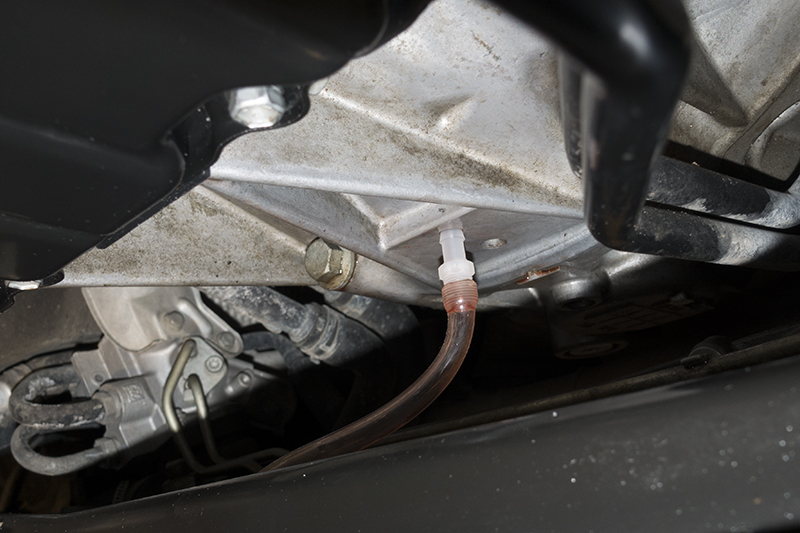

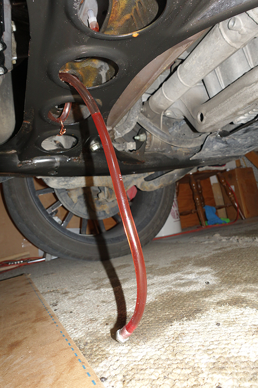

Sorry it didn’t sell Lewis, but $400 in labor, wow, I’m looking at 2 grand here! So as a true Poorsche owner, check out my short term solution. I basically catheterized the bell housing; I put a nylon hose fitting into the hole where the ATF leaks from, ran that into a clear tube with a sealed end. The goal was to separate how much was leaking from the gasket still and how much (and how fast) it was coming out the torque converter seal.
The line tucks up inside the cross member when I am driving. After a few days I can see now that all the ATF is coming entirely from the seal, and I am losing about 5 mls per day. That gives me about 3-4 months before the transmission starts acting up I figure.
Ironically the system actually works pretty well, no more mess or drips. So now all I have to do is slap a 0.2 micron filter on the line, tap a port into the transmission and recirculate the ATF, problem solved! Just kidding...kind of!

Catheterized......lol classic, had me laughing in the car earlier when I read it.
When mine first leaked it was on the warehouse floor and left a decent puddle. I then pulled of the covers and restarted the engine and it ran/drip fast. Your leak is a lot slower than mine.
Just be careful it might speed up at some point.

Zakowsky: Love the [temporary] solution. It's actually pretty insightful to know what rate you are leaking.

Thanks guys...yeah, it was like one of those, I should just put a **** hose in there which became, well maybe that is not a bad idea. The leak is holding at 4-5 mls per day, and seems not to change with how much or how hard I drive, so much less than yours Lewis, which I guess is torn rather than damaged. I have a friend in town with the same vehicle, same problem, and we are shopping around for an indy to do the work at a reasonable price. But in the mean time I can keep driving it with no mess and monitor if things go south fast. For all I know it could have been leaking since I bought it, and this just lead to the large build up under the protection panel that soaked the pan, and I only saw it when it extended to the frame rails on either side.
