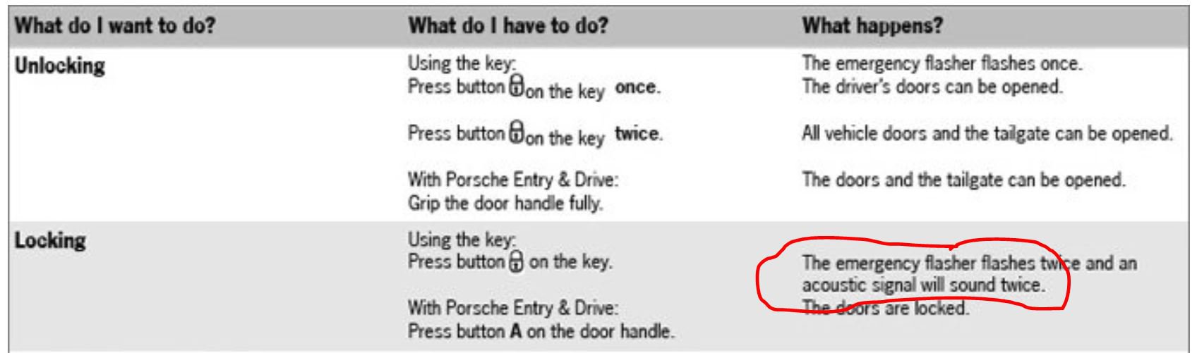

Loren, two alarm chirps is correct when the car locks.
see page 20 of the 2011-2012 Cayenne manual - extract below.
13 minutes ago, Loren said:
Alarm chirps and Locking chirps sound very different. Which is yours? a normal locking sound?
Okay then I don't understand. The locking chirps are made by the alarm siren. I'm talking about the locking chirps - I think Johnny is too.
[sorry - I wrote "alarm chirps" - now edited]
