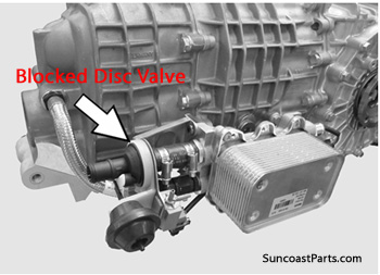

We have seen fault codes are P2181 (thermostat stuck open) and P3081 (engine coolant temperature implausible) on GT cars caused  is a blocked valve on the trans cooler (photo), but your car should not have that.
