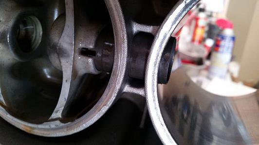

Maybe the metal flake in the link.  It was just floating around in my sump. Looks to be casting piece that broke off as one side has the same machine marks as all the other surfaces in the case.  There really was a poor job done cleaning up the castings edges.  There were no other indications of chains or anything else impacting the cases.
OR
My thrust bearing was shedding quite a bit of metal so that may have been causing the aluminum as it went through my oil pump and other areas. The scavenge pumps have scrapes also so any little particle stuck in there just makes aluminum as they go around and around.  All these things have been fixed and the metal has hopefully 99% cleaned out so we shall see........
