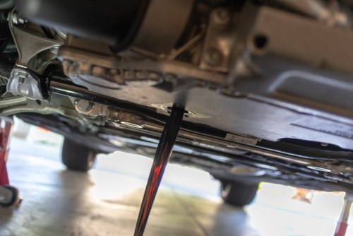

Note: Part numbers sometimes change without notice. Always double check with your supplier that you have the latest part numbers. Parts you will need: 1 ea 948 107 222 00 Oil Filter 1 ea  946 107 322 75 Oil Filter Housing O-Ring 1 ea  900 123 152 30 Drain Plug Seal 9 ea  Mobil 1 0W-40 or equal Tools you will need: Tire ramps or jack/jack stands T20 Torx driver Trim, panel tool 8 mm Allen wrench or Allen hex socket Oil filter wrench with 36 mm cap socket Socke
