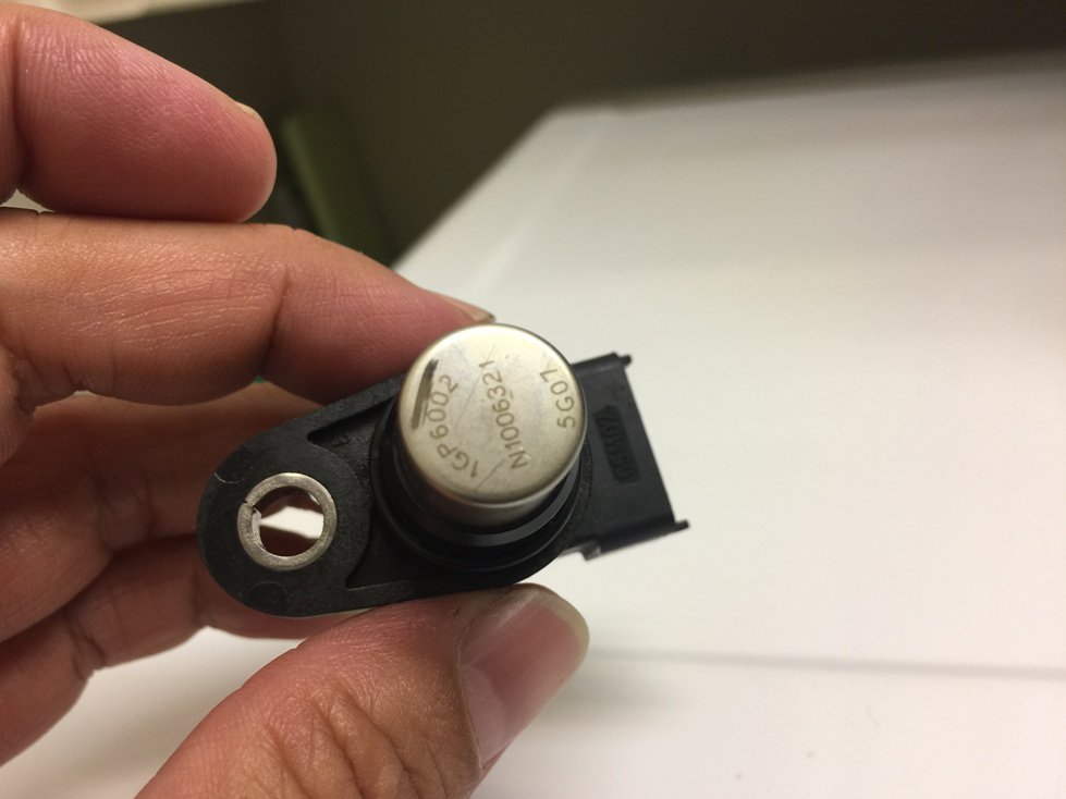

After some further inspection of the old sensor, I do see some scuff marks on the metal part of the senor.  Not sure if the trigger wheel finger is touching it and caused that mark.  Please see photos.
