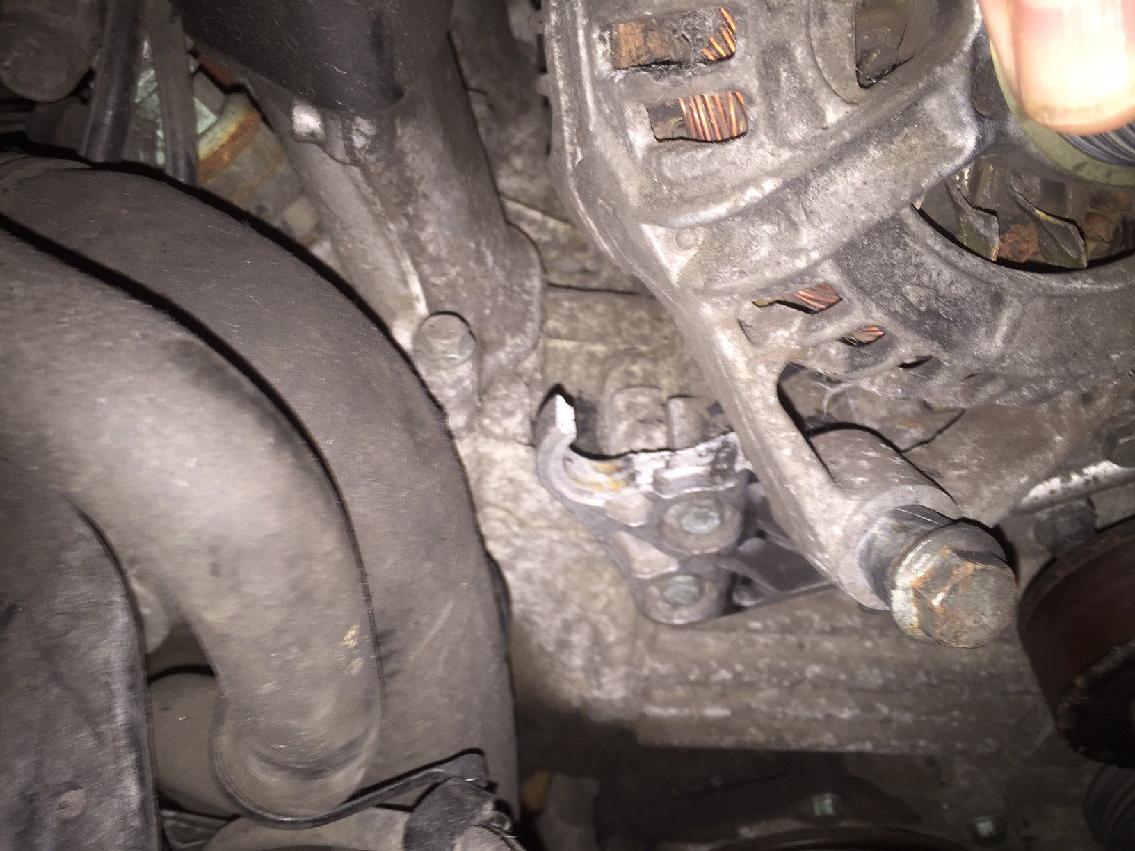

I was driving my car the other day and the check engine light went on.  Today I drove to an auto parts store to read the error codes, P0410 & P1411.  Error codes related to emissions and cold starts.  Long story short, driving home I hear an odd squeaking noise, pull into the garage and see this.  A bracket holding the alternator broke, shredding my serpentine belt and possibly trashing my engine.
Does anyone know the part number of the broken bracket?
Is this a DIY replacement?
Also, if I remove the screws hold the bracket to the engine case will coolant or oil come out?
Thanks in advance for your help.

That coolant lid/bracket can be replaced $380 from sunset porsche parts 99710102100
You can alao try to find a used one.
Coolant will pour out if you remove the lid without draining the coolant first. Suggest you upgrade to the 997 150A new alternator from Bosch (cheaper).
Thanks for the assistance.  New part and gasket coming in.  A couple of questions?
How do I drain the coolant?  If so, does it need a new crush washer?
Do I need to apply something like gasket sealer?
What do I torque the bolts at for the bracket(on the left side) and the roller bolt holding(right side) of the alternator?

Sure.
1) See figure 4 here. Yes, a new crush washer would be ideal. Also you may want to use a vacuum tool to refill.
2) No gasket sealer. There should be a metal gasket 99610133150 for that coolant lid/bracket
3) I'll get back to you on this

The M10 long bolt the alternator pivots on should be 34ftlb if it's grade 8.8. It's 48ftlb if it's grade 10.9.
No idea about the second bolt on the alternator.
The idle pulley M8 should be 17ftlb
Note M10 means the shank of the bolt is 10mm in diameter and M8 means 8mm.
