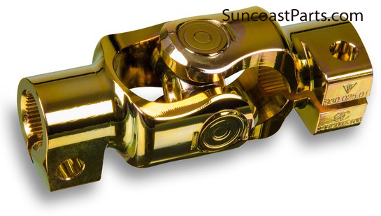

1 hour ago, JFP in PA said:
Here is a photo of one of the shaft joints, you can see the bolt hole for the pinch bolt that secures it to the splined shaft ends:
93034702501%20911%20porsche%20carrera%20
Is this part accessible from the interior of the car, or underneath? Is it possible to tighten them without removing the steering rack?
The lower one yes, the upper one is very restricted and I don't think you can get a tool on it assembled.
