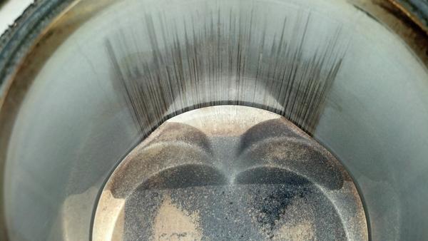

Cylinder scoring is a major problem on all alloy engines, particularly those with DFI fuel systems. It is not just limited to Porsches:
Once this happens, you need a rebuild.  Some of the major contributors to this is fuel puddling  which washes the oil off the walls and piston skirts, again particularly on DFI engines, although it can occur on earlier injection systems as well.  Allowing the engine to warm up helps, but the largest corrective measure you can take is quality oil (read high levels of ZDDP) and frequent changes.
Sooty tail pipes is an early indication of this type of issue.
