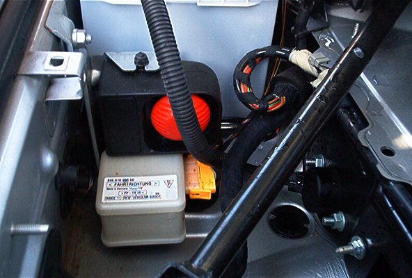

If the car started, then it has recognised the immobiliser code, so it sounds to me like the programming is correct.
Do you have the alarm siren?  Is it the siren which is going off when you remove the key?  The siren is to the right hand side of the battery, as you look at the car from the front.  If you have the siren then I suspect it has a bad backup battery inside.  With the ignition switched on, unplug the siren.  Then see if the alarm goes off when you switch the ignition off and remove the key.  You might get a beep from the alarm horn (a separate horn on the other side of the battery) when you lock the car, because the siren is disconnected.
Wow Wow Wow..... It works now !
