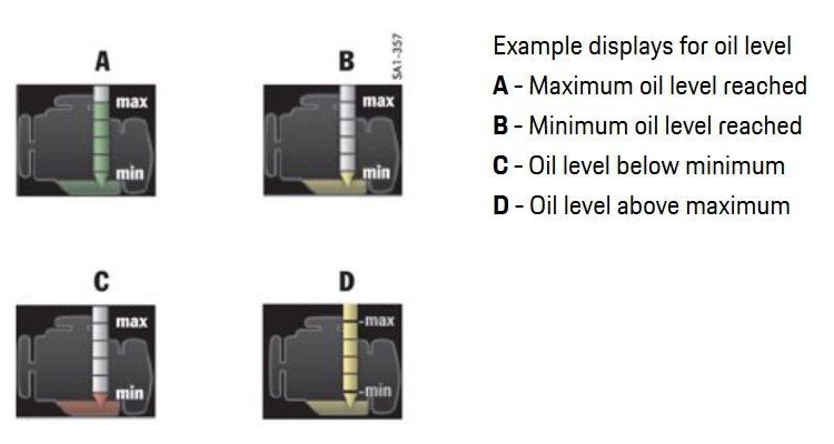

On my first oil change, I over-filled it by 1.25 liters all due to the fact I did not fully understand the Oil Measurement Display.
I thought the MAX level was at the top of the bar, which it isn't. The MAX level is shown in A below.
Anyway, I just drained it and the level is at MAX.
I also would not use a vacuum pump for the reasons mentioned.

I have had this show up my both my CGTS and GT4. Much ado about nothing as far as I can tell. I have drained oil off by loosening the filter, or just let it go. Done several track weekends with the alert notice on. Problem is not simply overfilling, but under-draining by the car, imho.
