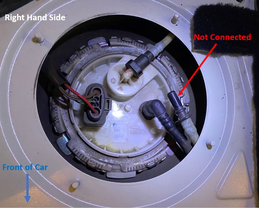

I changed the tank vent valve and it did not make a difference. The annoying sound remained. Continued to drive the car until this weekend when I decided to have a look at the fuel pumps. When I took the back seat out and removed the cover of the fuel pump on the right hand side of the car, I found what looks like a vacuum or vent pipe that is not connected to anything. See attached picture. I had a good look around and could not see any other pipe that this is supposed to connect to. I started the car and when the tank vent valve activated, it began to pull a vacuum on this pipe which in turn started to make the "puck-puck-puck" sound, at a frequency of about two puck-pucks per second. When I put my finger on and closed it, I could feel it pulling a vacuum and the sound stopped.
I now put a cover on this pipe and blanked it off and the annoying sound is gone, but I am wondering what it's for and where is it supposed to be connected. Based on the date stamp on the top cover of the fuel pump, it does not look like it has been changed.
Any ideas what this pipe is for and what it is supposed to be connected to?
