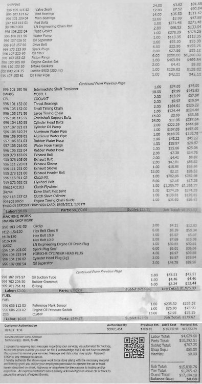

Purchasing 911, car had engine rebuild in 2015, no mention of ims bearing

If the engine was a 2003 (you can tell from the numbers on sump rail), it would have the small, serviceable single row IMS bearing from the factory.
If the paperwork does not mention the IMS, it was not done.

 A 2003 would have the smaller single row bearing.  Just get it replaced with the Solution and you are done.
