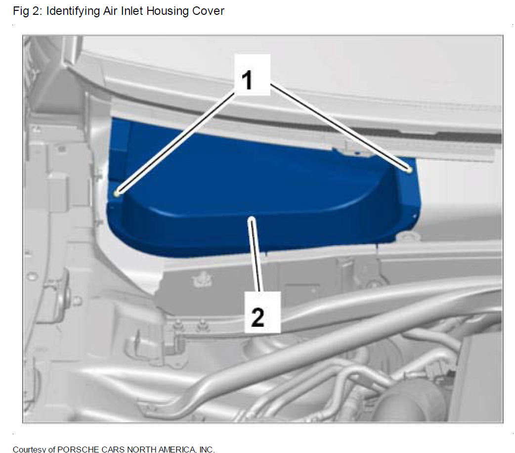

Good Evening, any way possible I can get some guidance in replacing  this sensor I have the same issue now on my 17 Base Macan same Code D10002, any possible way to provide a picture where I can see the exact location of the sensor or guidance?
will appreciate your help.
Thanks
CM
The inner temperature sensor is located on the right in the plenum panel (at the air inlet housing for air conditioning).
1. Unscrew fastening screws and remove air inlet housing cover 2.
2. Turn inner temperature sensor clockwise arrow and remove it to the rear.
3. Disconnect connector 1 from the inner temperature sensor 2.
Installation is performed in reverse order.
