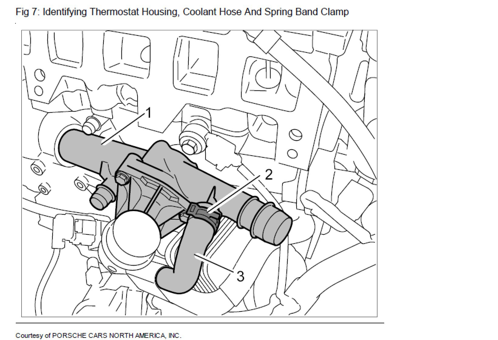

I have a 2012 958 base with a small coolant leak.  Based on the symptoms and that it is a common issue, I suspect it is the notorious thermostat housing leak.
I have searched all over online looking for the exact location of this thermostat housing.  Can anyone provide some guidance?  Can I inspect it from the top of the engine?  Or from the bottom?  What has to be removed to get to this area to inspect it for this leak?
 I understand it is supposed to be near the rear driver side of the engine but I removed the engine cover on this side to look for it and I could not find it.
Can anyone provide some guidance on where exactly to look?  Perhaps with any helpful pics or diagrams?
