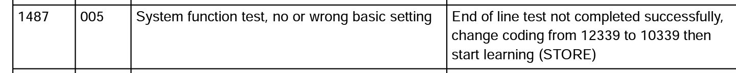

Fixed this, but now getting error 1487. Says to 'Change coding from 12339 to 10339'
I have no idea what is meant. Is it done in the Piwis?

Change coding in TPMS from 12339 to 10339 as it told you!

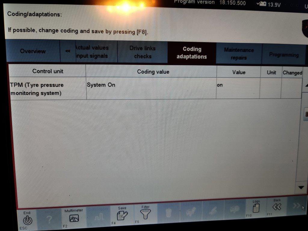

Under coding adaptations it only says General coding and in there i can do "System ON" which is on currently, or i can change instrument cluster type..

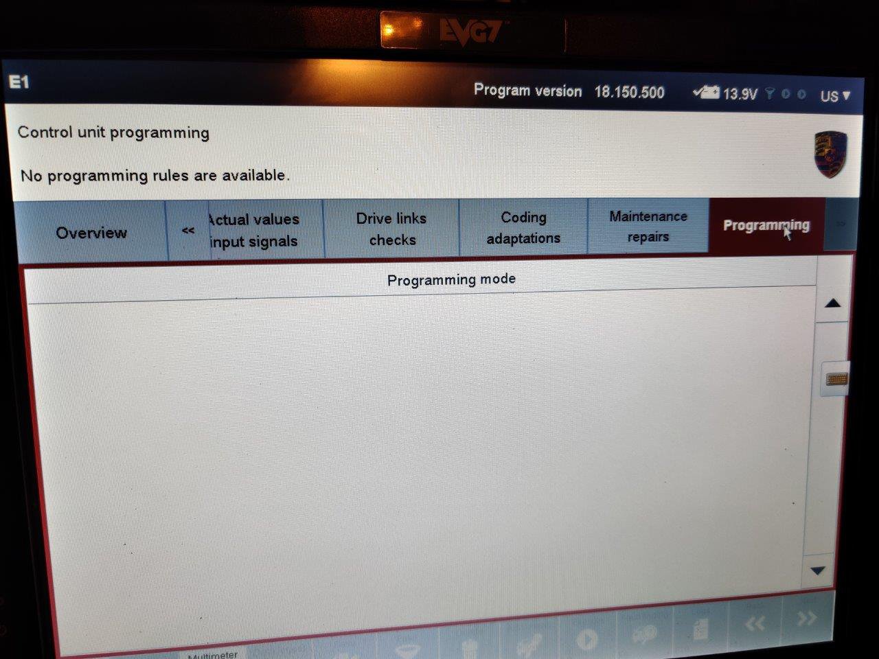

Under Programming tab I have nothing and it says "No programming rules are available".

With the mouse or pen highlight the item - then the F8 button should show up for changes.

update, I have gone into Developer mode E. Now i see a text field labelled "Coding" with a value of 0B28B1.
Here I can't input the 10339 value, because it states that the field must be 3 digits only.
So stuck again 😞
