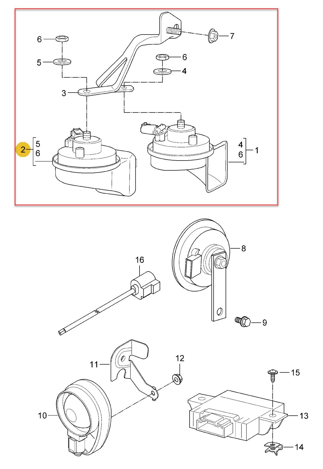

So can anyone help - I need a horn replacement and dealer says are 2 of them for my car, a high tone and a low tone.  I only see one, to the L of the battery and I dont know the part no. or if there is another?
High Note Horn - Porsche (997-635-206-04)
Low Note Horn - Porsche (997-635-205-04)
The horns are behind the front bumper. IMHO they are poor quality.
The factory replacements are:
997-635-216-00 high pitch horn (newest) - US MSRP $51.60 -- plus adapter cable 997-612-947-00  --US MSRP $22.73
997-635-216-00 low pitch horn  (newest) - US MSRP $51.60 -- plus adapter cable 997-612-947-00  --US MSRP $22.73
or
you can do what I did and replace them both with a single electric air horn.
tks guys.  ill check it out.  noticed ill need to remove the front apron.  looked for some diy here, but saw none.  still looking.  tks again.
