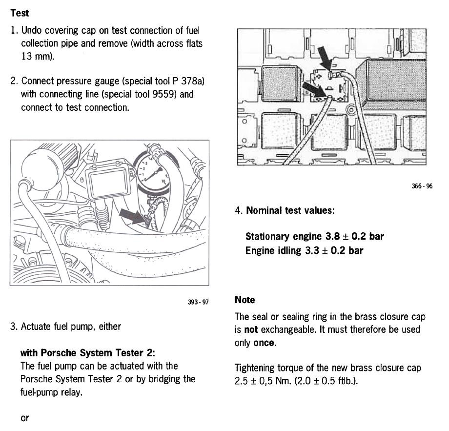

Yes, that is the correct Workshop Manual section.  Maybe someone with experience will weigh in on the pressure testing tool.  I don't believe there is anything unique about the pressure testing port (schrader valve on the fuel rail), maybe a local auto supply stores might have one that will work. What you want to see is if the fuel  rail stays pressurized with engine off, or if it bleeds down, meaning the fuel injector for #3 is stuck open as JFP pointed out.
Edited by DBJoe996
Thank you! Found in some other older thread that I need a M14x1.5 to M15x1.5 adapter for a standard pressure tester. That confuses me, why would not a M14x1.5 to 1/8” NPT adapter work? I thought 1/8” NPT was the standard pressure tester connection.
