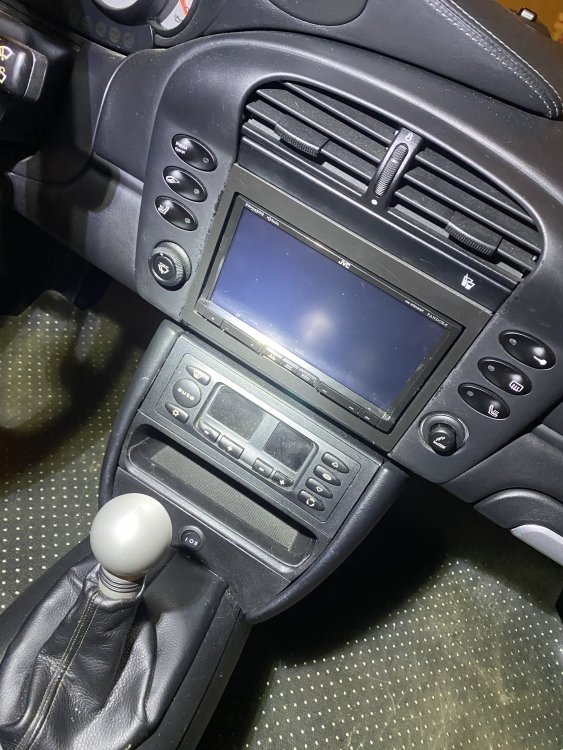

I share your need for fun... here's my center dash that I've re-worked to suit my needs..
You have the PSE!
... I wish I had the PSE ...
