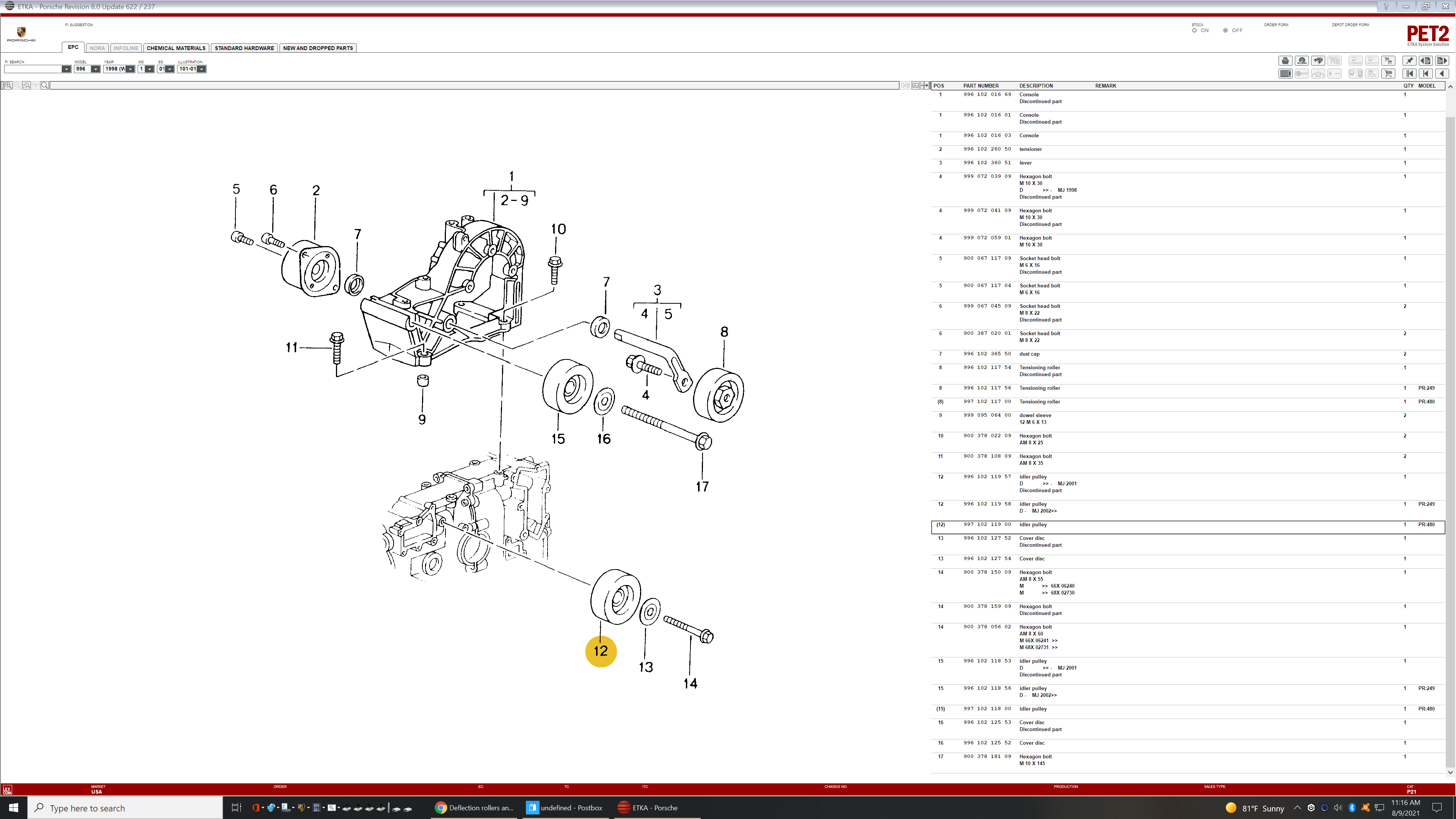

Hi All, My lower deflection roller exploded on the highway earlier this week... bummer.
My car is a very early 1998 996 manual transmission car and I'm unclear on what parts I should use to replace the deflection and tensioner rollers. Can I use the 997-102-119 parts on my early model car? The PET catalogue calls for a 996 part that I can't seem to find online (only the tiptronic part seems to exist). Any advice on what to use? Looking to replace all three rollers but getting mixed messages from the online vendors on what fits my car.

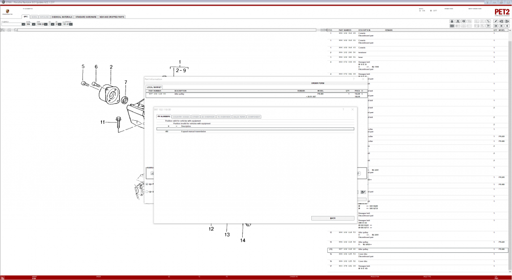

I see the same situation for the upper deflection roller (what I believe you're calling an idler pulley). The 996-102-118-56 part is listed as a tiptronic part. There is a 997-102-118 part listed for M480 cars. I've attached a screenshot of the PET but it looks like the same situation as the lower roller, for which you said I could use the 997 part.

Thanks. So what I'm seeing is, the 997 parts for all rollers are the right parts for my car. Thanks very much for your help, Loren.
An aside, for those of us left using the out of date PET... the A beside part numbers means discontinued part.
