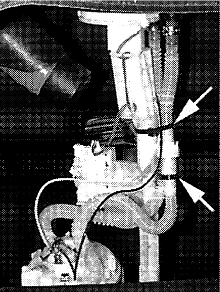

There are at least two and perhaps 3 TSBs for issues will the fuel filling lines and/or vents on the C4 and C4S.
TSBs should be performed for free by your dealer -plus they should have a record (that follows your VIN) for all TSBs that have been completed for your car.
Contact your dealer and if they have not performed them that is the place to start.
